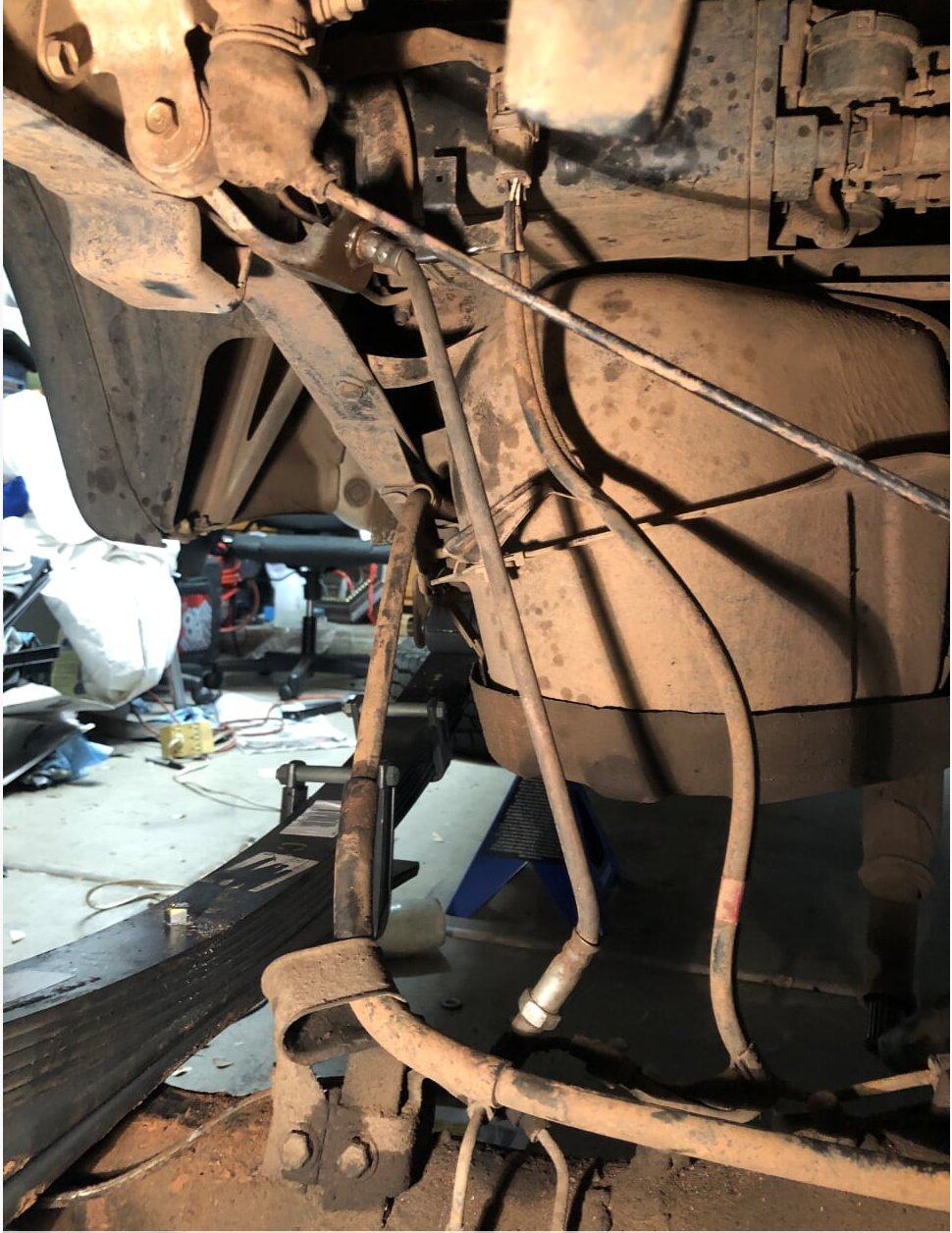

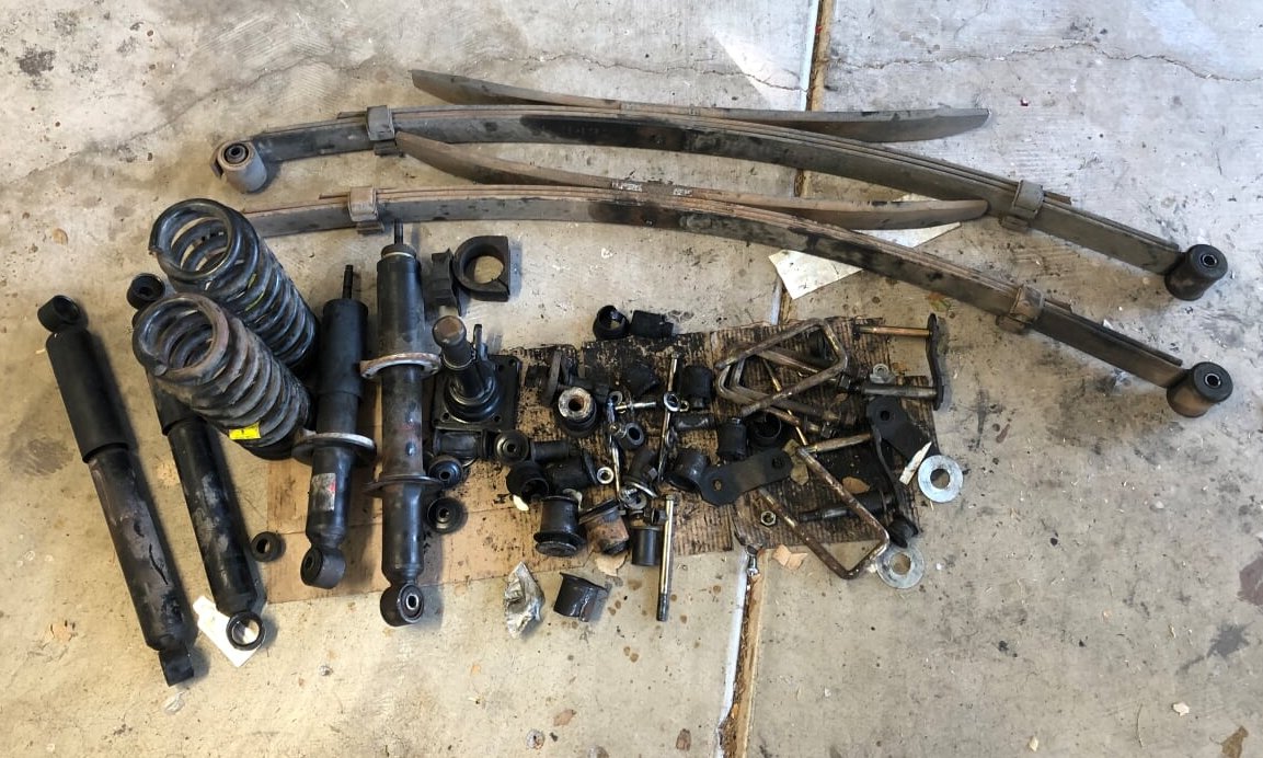

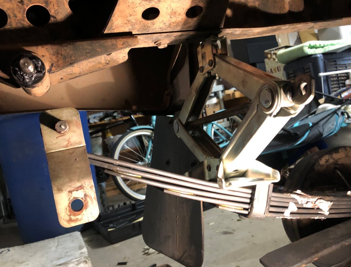

    Picture time!
    Bone yard (replaced parts)
    Getting those pesky leafs lined up
    The little brake line that could. Really amazed this didn't snap. Not my smartest move.

    Before the axle slipped off the jack. Really should have ponied up for some more jack stands and put a towel between the pumpkin and the jack for a little more grip.
