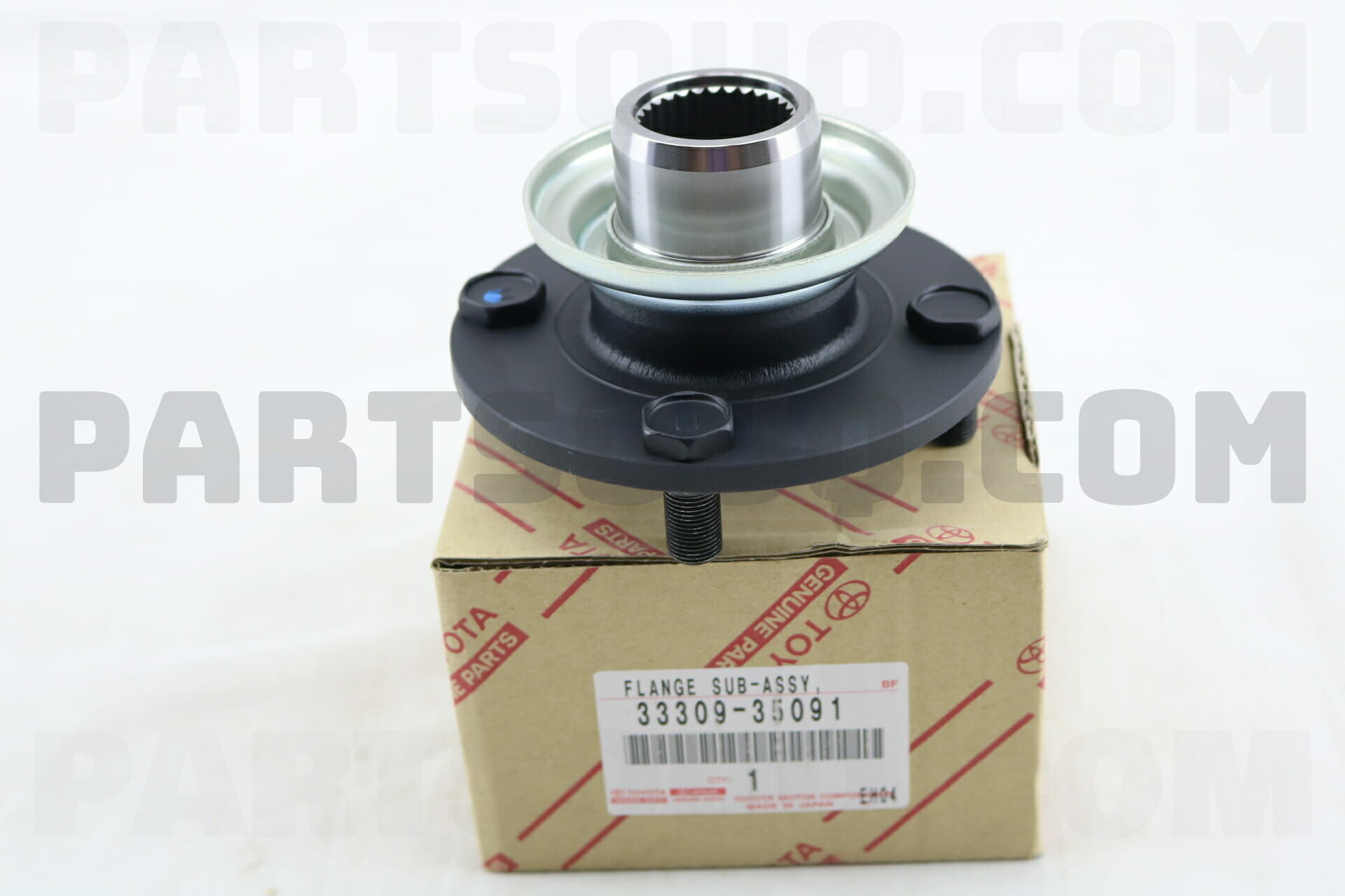

    It looks like the studs are sold as part of a hub assembly from Toyota. IIRC, those studs are pressed in the hub. If they are replaceable you would have to remove the hub to access that to see if they can be pressed out. If so, you should be able to find a press-in aftermarket stud instead of having to buy a whole assembly from Toyota.
    This is the one for my truck. There is no guarantee it is what fits your truck.
    Which end of the driveshaft are the studs messed up. The pic above is for the hub coming out of the transfer case.

    Yes the transfer case … I’ve already removed them with out removing hub… so I’m thinking/ hoping I can replace them without taking apart more of the truck … thnx for the web page

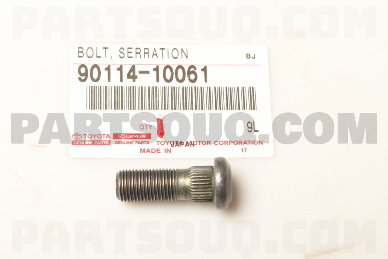

    I might be wrong but I remember those as being special bolts not studs . I changed quite a few over the years. No telling what one might find on a truck this old.

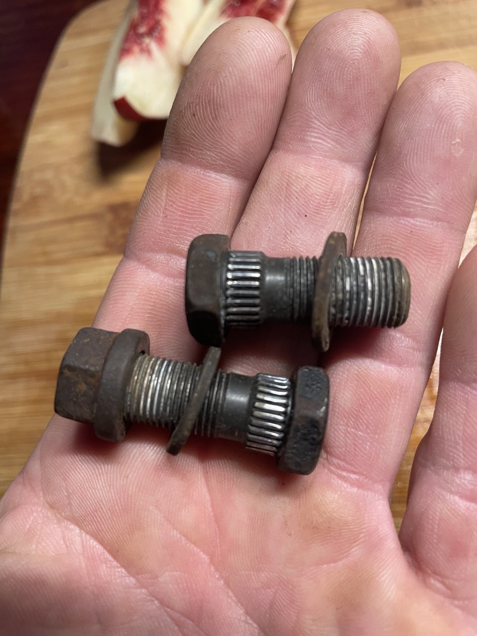

    Yeah they are special bolts but apparently Toyota thinks of them as post/ studs at least that’s what they were telling me at the dealers …here is a picture of them

    I suck at the internet and don’t know how to post picture on this forum

    In the area whey you type in your response, the 'upload a file' button will allow you to select a photo stored on your device.

    Is there enough space behind the yoke to use a regular bolt and nut setup like where the driveshaft connects to the third member?

    I came up with the PN for a land cruiser, I'm not sure if it fits Tacomas as well. Maybe @Empty_Lord can spare a minute and confirm
