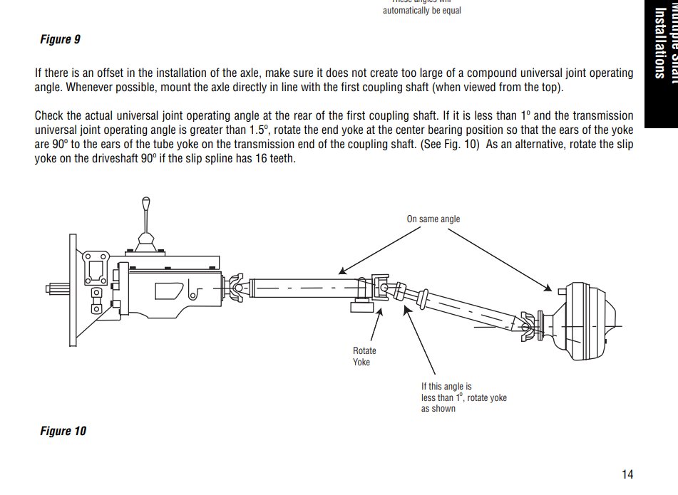

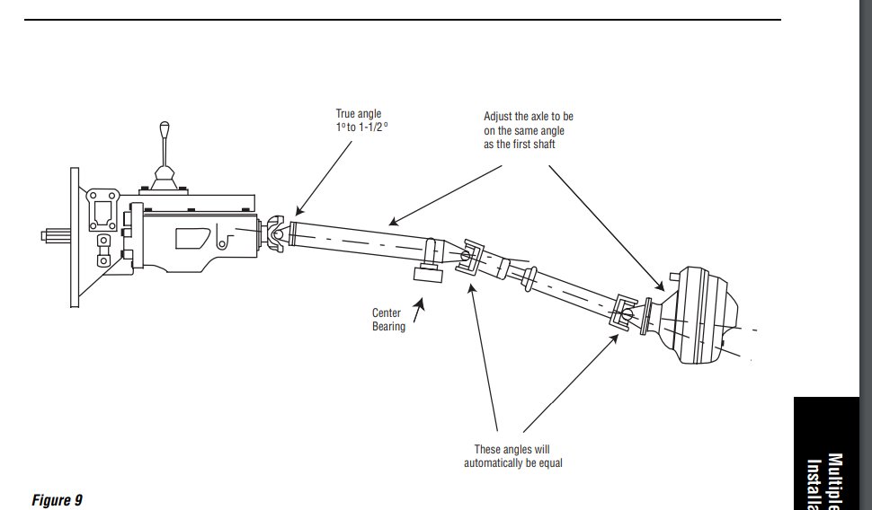

    you gotta get out and do measurements and see where you are at. The easiest way would be to zero your angle finder on the bottom side of the shaft between the tc and center carrier, then take your angle finder and place it on the bottom of the pumpkin of the rear axle. If its zero this will let you know that the working angles of the center joint and the rear joint are equal and opposing. Then you can measure the working angle of the joint at the tcase
    Its bad practice to reference off the ground for driveshaft angles. Reference off a surface (theres a great flange on the tcase) of your driveline as the driveline is what needs to be oriented properly to itself, not the ground. You do not want the shaft to be (both pieces) inline with each other as the phasing (how the u joints are oriented rotationally along the shaft) is not setup to cancel out vibrations via the front most and rear most joint. It can only do so via the front and center, or center and rear.
    https://www.waterousco.com/media/wysiwyg/pdfs/content/J3311-1-DSSP.pdf
    page 16 (labeled 13) Multiple shaft installation through page 17 (labeled 14) will be in your interest.
