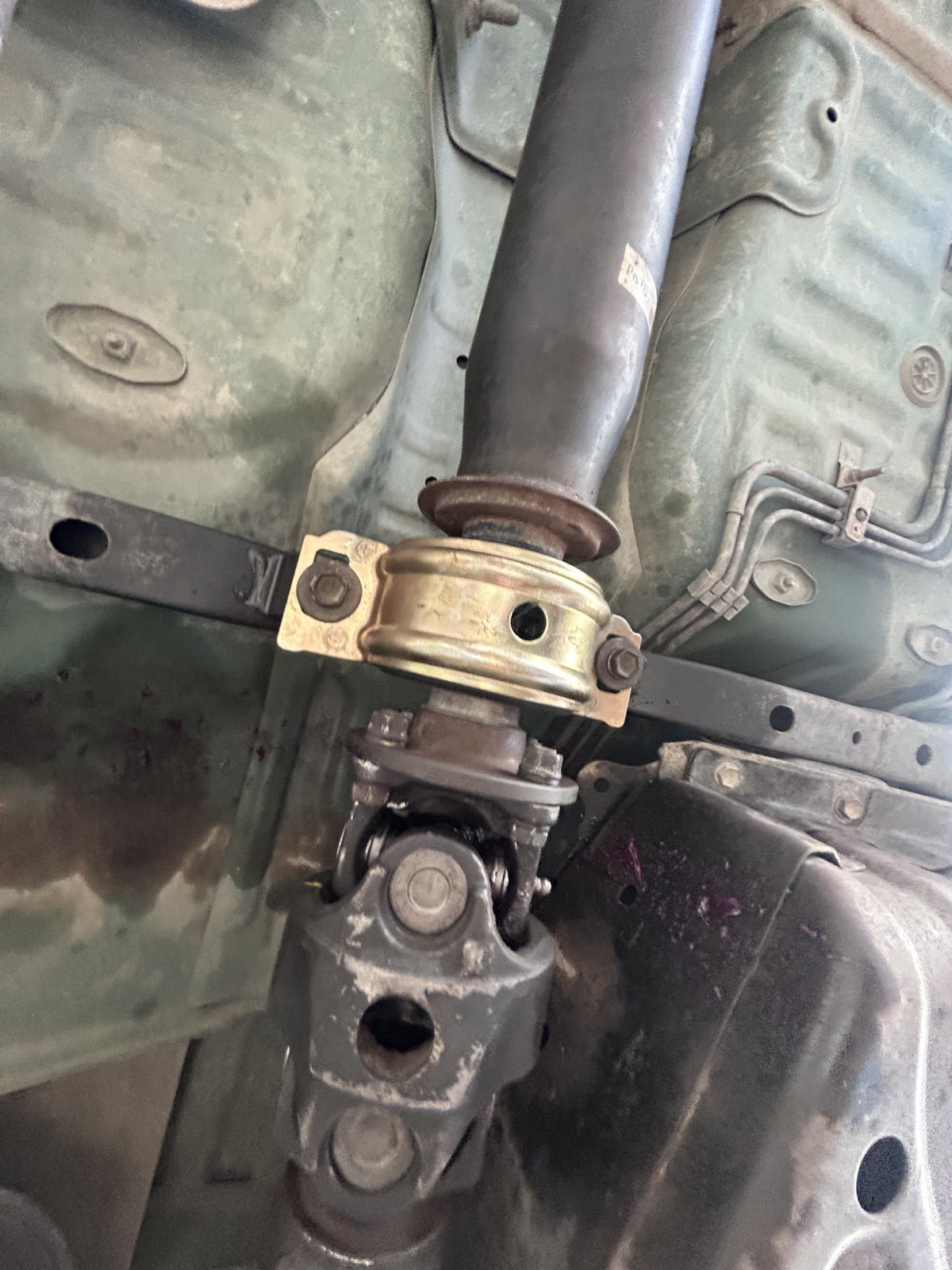

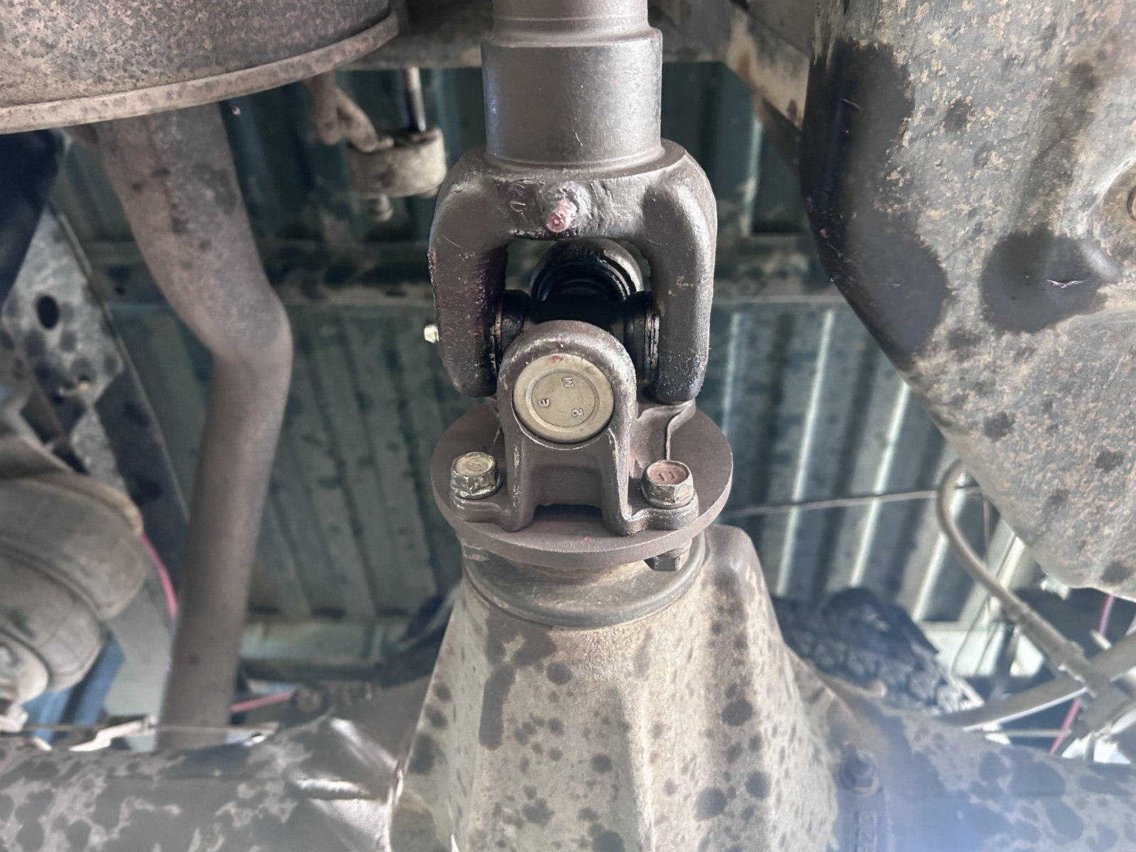

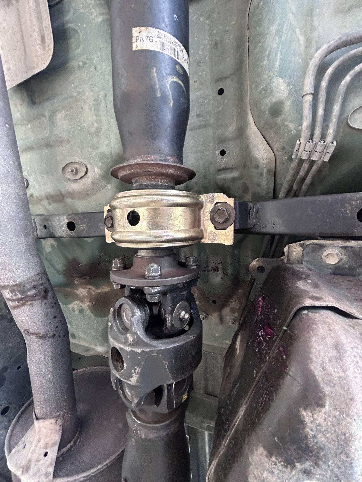

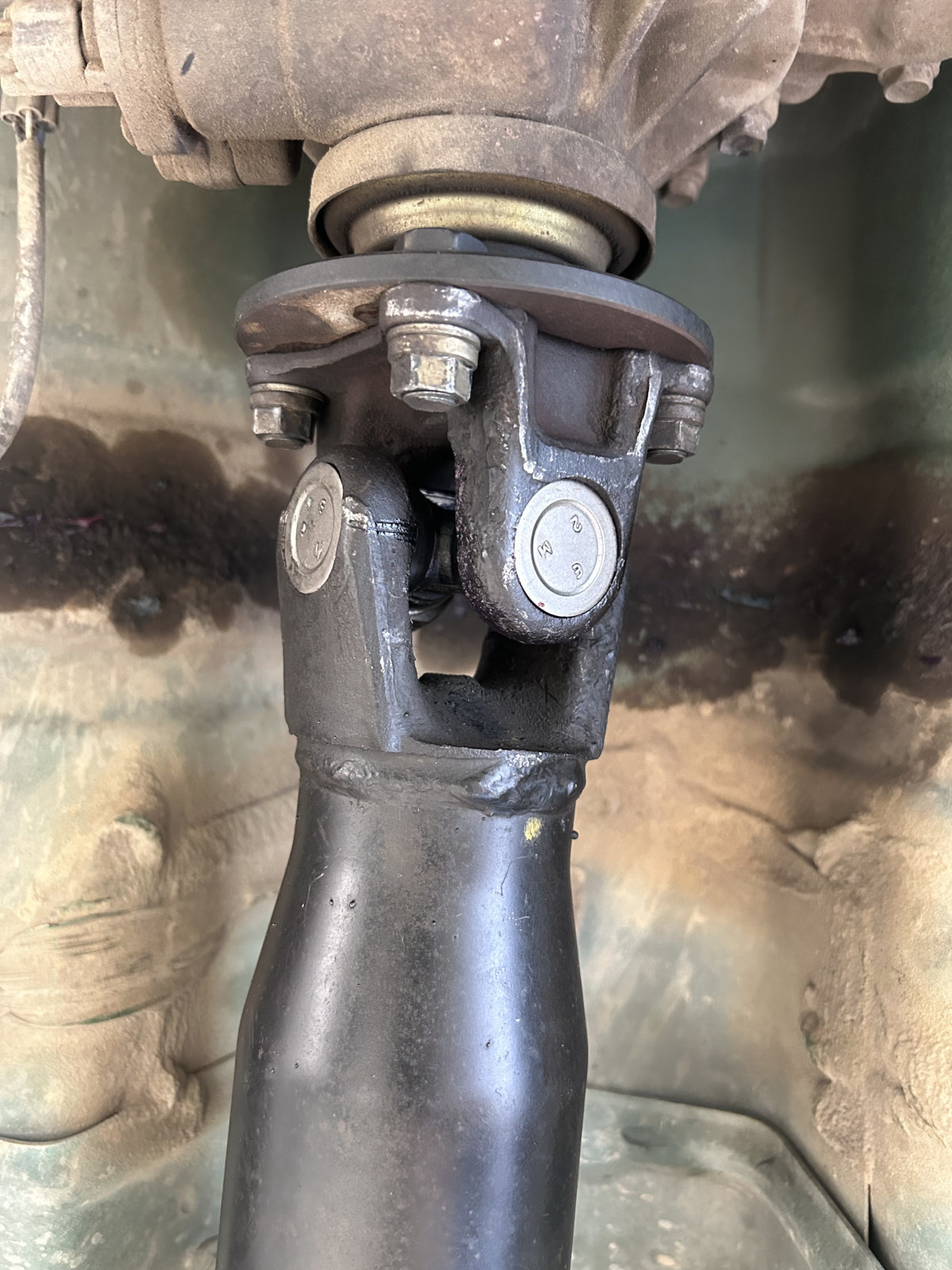

    I had this exact issue and it was resolved by replacing a couple of the U joints that had some play in them and Rebuilding the Center driveshaft bearing mechanism. This happend at 310K miles. Its running perfectly now.

    Did you service the double cardan joint or was it a full replacement with a spicer or similar joint?

    2000 tacoma sr5 3.4l V6
    I'm not a mechanic but here are pictures of what they worked on:
