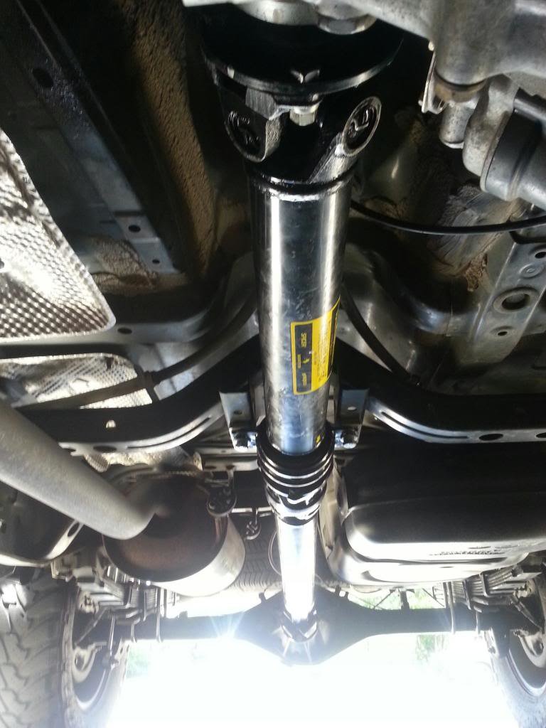

    FINALLY solved all my vibes with this custom built 2 piece double cardan driveshaft!

    Take off shudder was my main issue. I had tried many combinations of CB drops and degree shims with no success. I'm running a 3deg shim and no CB drop with the 2 piece double cardan drive shaft(w/factory new CB). I considered a Tom Woods 1 piece, and it actually would have been cheaper, but I didn't want to lose the ground clearance or worry about the added weight on the transfer/trans seal.
    Photo Does show the CB drop installed, but I removed it as it wasn't needed.

    Hey ndcmack, just out of curiosity.... in your photo, it looks like your driveshaft bows to the left in the center, toward passenger side. In other words, your CB might need to go toward the driver side as much as those sloppy mounting holes allow. Could just be the light or the photo angle, only pulling a string from TC flange to pinion flange would show for sure. Folks often forget, in our shimming madness, that side to side is as important as up to down. Just an observation, congrats on vibe free!

    I think it's just the angle of the picture, but I'll double check it. Thanks!

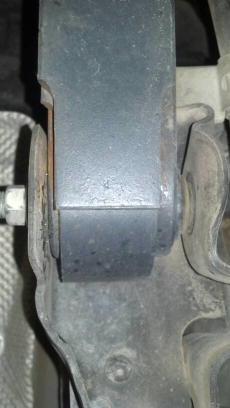

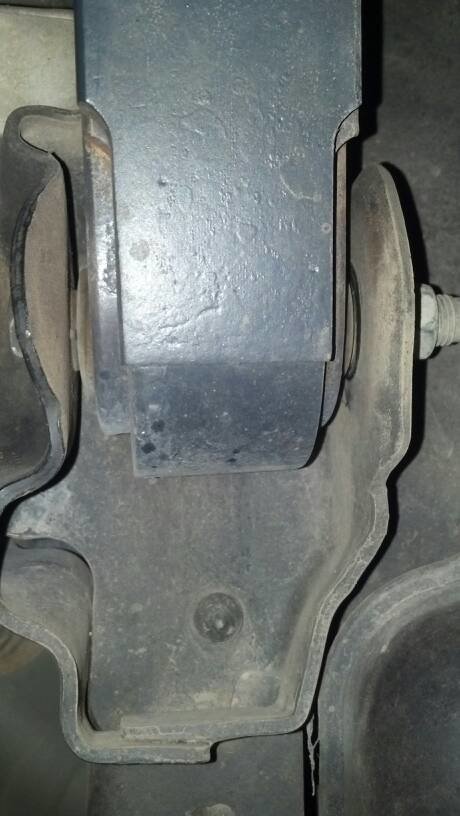

    Driver side fwd leaf hanger.
    Pass side fwd leaf hanger.
    After a long painful few weeks of trying to figure out what seems like the same vibrations a lot of us get ( I have set my drive line angles perfectly) and I still have vibrations throughout the whole truck, I once again crawled under to try to figure out what the f*#$ is causing it. Can anyone see what I'm seeing in these pictures? By the way...these are Dakars.

    I had noticed precisely the same thing a couple weeks ago on my Dakars. Don't know what's going on, or why it's doing that. But from my experience, I doubt it has anything to do with vibes, since I have none (other than takeoff shudder, which I'm pretty sure is axle wrap).

    I'm not sure if this could be the cause of vibration, but the fwd pass side bushing isn't centered and there is displaced metal on the inside of the bracket where the military wrap is banging against it.

    What are your U bolts torqued at ?
  19. Jul 24, 2013 at 8:04 AM
    #379

    Interesting
    I had one of my Dakar packs walking sideways too for a bit
