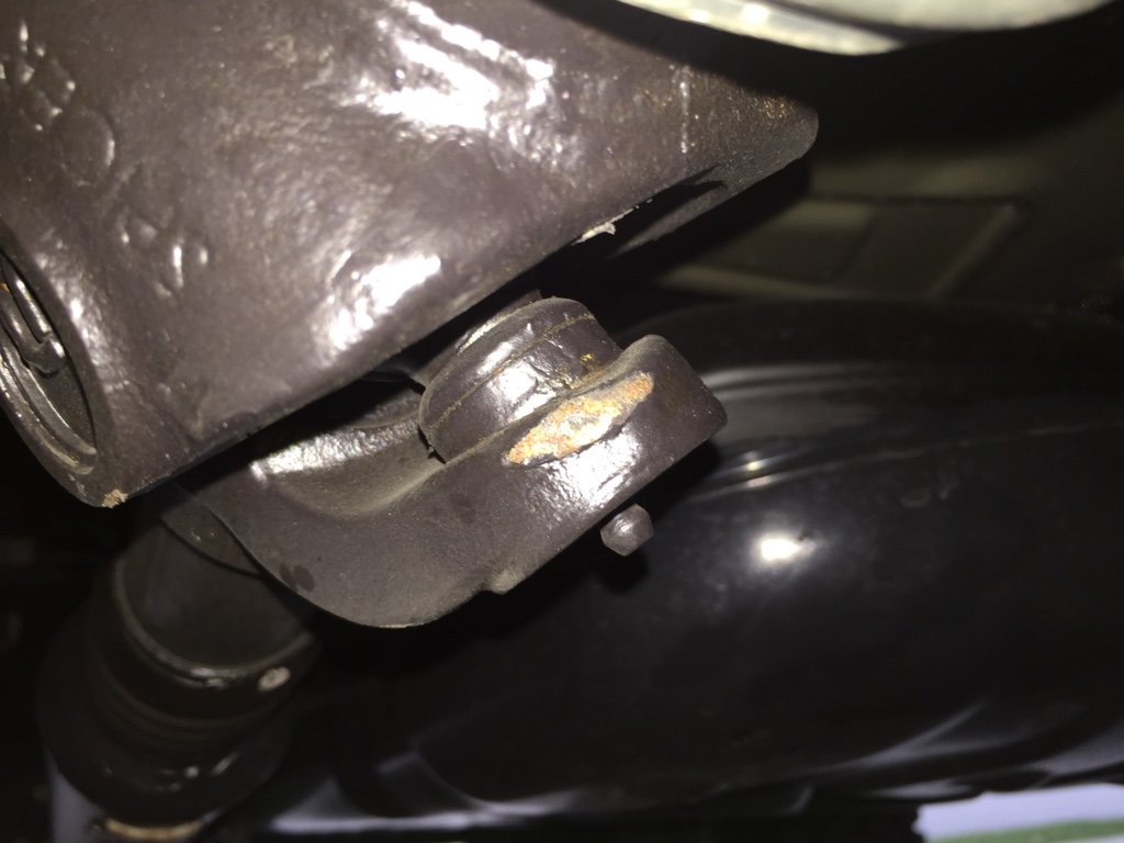

    Tried the Beefed Taco CB bracket, but still haven't fixed my vibes.
    Was looking around under the truck today and spotted these scratches on the yokes of the joint by the CB
    Anyone ever see anything like this?? Gosh I hope it's been there since the factory
    Also the angle of the joint through the carrier bearing looks extreme to me, any thoughts?

    Angle is a bit high for sure, marks on yoke definitely look like they are coming into contact. If they are coming into contact, then the angle would cause a vibration for sure. My suggestion would be to run a temporary test and place a couple of washers on the back side of the Carrier bearing mount. The idea here is to add a change to the ANGLE of the mount, without changing the POSITION of the mount. I will be honest, from the earlier video you posted it looks like the carrier bearing assembly may be a little "soft" allowing too much movement when loading up. You have some REAL axle wrap issues there which I would believe is a contributing factor as well. Having these multiple small things adds up to one LARGE issue. I notice you have an AAL to your rear suspension. Have you considered, just as a test, installing a set of cheap traction springs to reduce the wrap and see if the shudder goes away?

    I guess I'm not understanding how the yoke's could be coming into contact to cause the marks. The angle between the two halves of the driveshaft is pretty minimal.
    Also, do you mean regular round washers behind the CB bracket? Wouldn't that just space it down without changing angle of the bracket?

    It would take extreme movement for the yokes to come into contact with each other, however the video you posted before shows some extreme movement. Have you taken a video that captures the yoke itself? This would be helpful. As for the washers, I am not meaning to place them in the bolt hole. What I am talking about I will try and show below. You place the washer half way in, between the CB drop kit and the CB itself. Doing this on the left and right sides. (NOT the front and back, so only one washer per side) This will force the carrier itself to alter its angle, rather than simply moving the carrier up and down. It's not meant as a permanent fix, but just simply a testing method.

    As far as the angle goes, got it.
    Still worried about the wear marks, I can't help but think if it was making contact while driving it would make a horrendous sound, more so than a slight vibration.
    I think I will add some paint or chalk and see if it is still making contact
