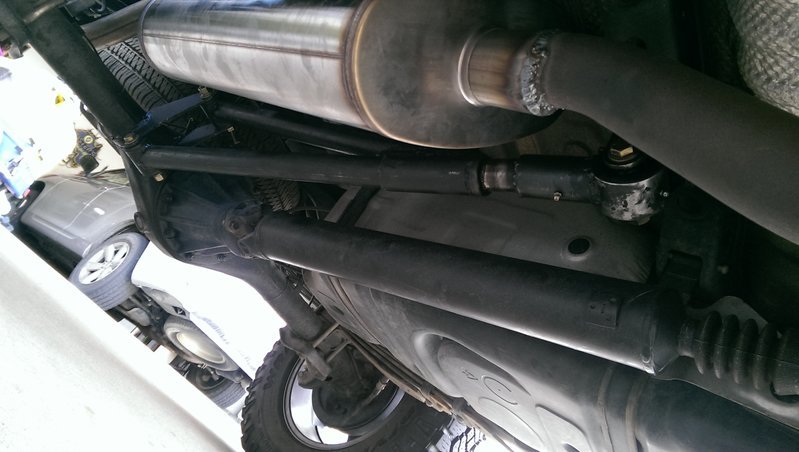

    After almost a year of trying numerous driveshaft setups and angles I determined that it doesn't matter because axle wrap is the true problem. You can have all of the angles correct but once the axle wraps they are all wrong. I first added Helwig helpers to my leafs. It reduced the shake by about 50% but made the ride too rough so yesterday I made a ladder bar for my axle. Finally the vibrations are 100% gone. Mine vibrations were completely caused by axle wrap.

    Still need to finish painting it, but here it is.

    And this setup is 100%-vibe-free? Good work.
    I'm not really up for welding anything onto my 2015 @9000 miles, but if there was a bolt on solution out there they'd get my money.

    Budbuilt makes one. I had to put a new muffler on to make room for it. I don't know if the budbuilt fits with the stock muffler.
