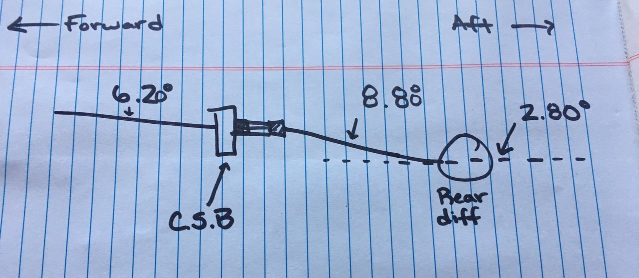

    So to eliminate drive line vibrations. What should I do? My current measurements are in the pic below. I removed the CB drop and have 3* axle shims in stalled. Removing the CB drop did improve the vibration a little, but not completely. [​IMG]

    That Trans angle is just so shitty. You could go the TSB trans mount route and reduce it some.

    Based on the picture, looks about right. I would look closer at your U- joints and center bearing for possible replacement. Those numbers are not bad at all.

    I'll have to search for the P/N, but it's a lower profile trans mount that helps reduce that first angle.

    Measure the angles on a flat and leveled place, calculate the angle in the back and order shims.
