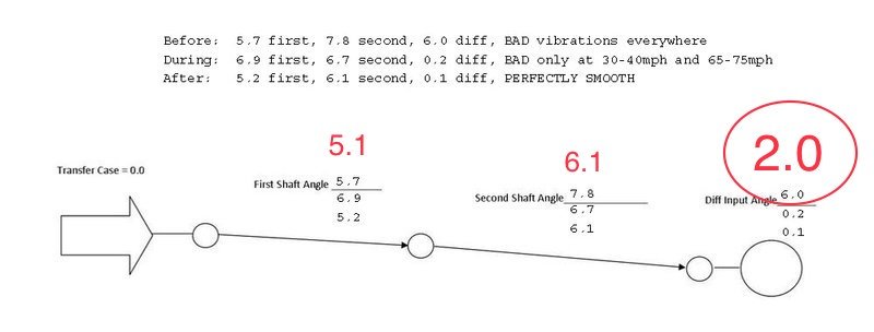

  11. Dec 30, 2018 at 6:28 PM
    #771
    Alexely999
    Alexely999 Well-Known Member
    Jan 17, 2016
    #175203
    2,157
    Alex
    Bay Area, CA
    2015 DCSB 4X4
    I’m working on this currently and I have a question.
    My 1st and 2nd shaft are the correct angle now, but my diff input angle is 2.0. Do I just need 2 degree shims? Is it that simple?
    Does the fat part of the shim go towards the front of the truck?
    2017 TRD Taco likes this.
  12. Dec 30, 2018 at 8:10 PM
    #772
    Alexely999
    Jan 17, 2016
    #175203
    2,157
    Alex
    Bay Area, CA
    2015 DCSB 4X4
    Anybody know?
  13. Dec 30, 2018 at 10:34 PM
    #773
    Clay7160
    Clay7160 Well-Known Member
    Aug 15, 2016
    #194623
    1,281
    2018 MGM TRDOR DCLB 4x4
    GYEON ceramic coating
    Fat towards the rear- you want .5 degree angle so that way that you joint getS LUBED. If the joint has 0° angle the bearings will not distribute the Grease
    Alexely999[QUOTED] and DrFunker like this.
  14. Dec 31, 2018 at 6:31 AM
    #774
    Alexely999
    Jan 17, 2016
    #175203
    2,157
    Alex
    Bay Area, CA
    2015 DCSB 4X4
    So then I would need like a 1.5 shim?

    I just finished replacing my carrier bearing with the IEDLS poly carrier bearing and center U-joint, double checked my drive line angles but I'm still experiencing vibration through the floorboard at highway speeds. Its from 40-50 and 55-65. Seems to stop as I approach 70. Anyone here experience this? It didn't start until I messed with my driveshaft, so I'm assuming my problem lies there, just can't pinpoint it.

    2 degree axle shims. Basically just found the angular difference between the rear diff and the rear portion of the driveshaft and got a shim to make them perpendicular.
