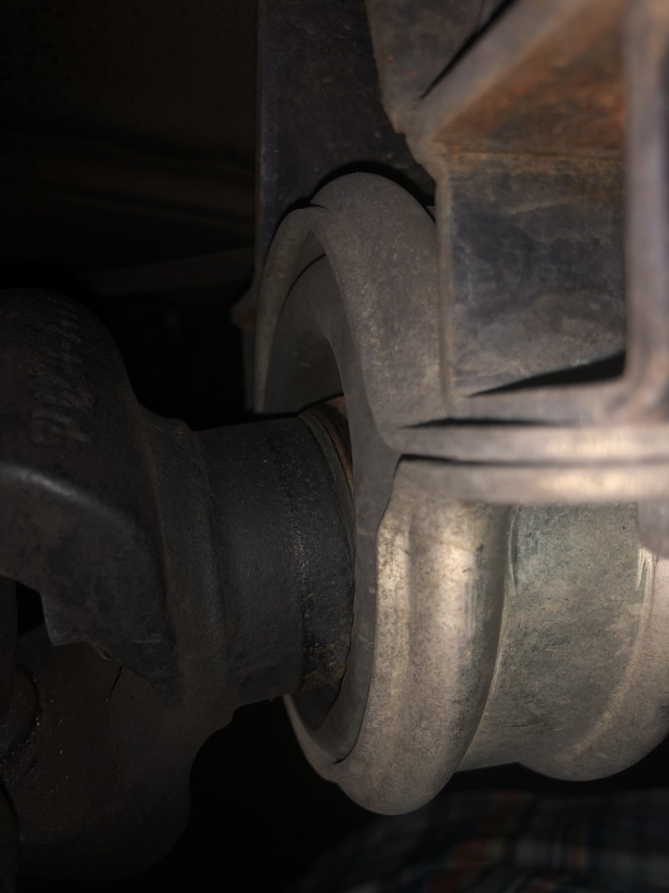

    Just downloaded the app and I'll be checking the angles and reporting back. I did notice in the app it has three angles to measure, I'll measure from the TC, the aft DS and Rear Dif, and then again from TC, forward DS, and Rear Diff.
    Truck did not have OEM shims. Dropped the OEM leafs, and installed the new leafs. Workmanship was pretty spot on, had the shop doing my alignment to double check my work and they found no issues on the install, as I always went back and double checked my work as I progressed on the install. Agreed on the 10.8 being very high, and it is definitely showing on the pedals and truck overall when slowing.

    Nockturno Well-Known Member

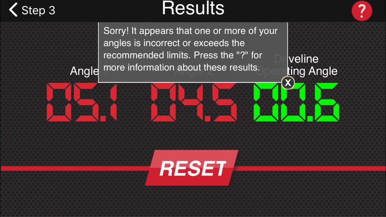

    Did my best on using the app. The phone is finicky was placing. Did the best I could before I froze under the truck. Did the two measurements from TC, aft shaft, and Rear Diff; and then TC, Forward shaft, Rear Diff. Pictures shown respectively. FYI, not sure what the app is reading out to me to be honest. Did the measurements before winter storm hits tomorrow. I probably have to redo the measurements.

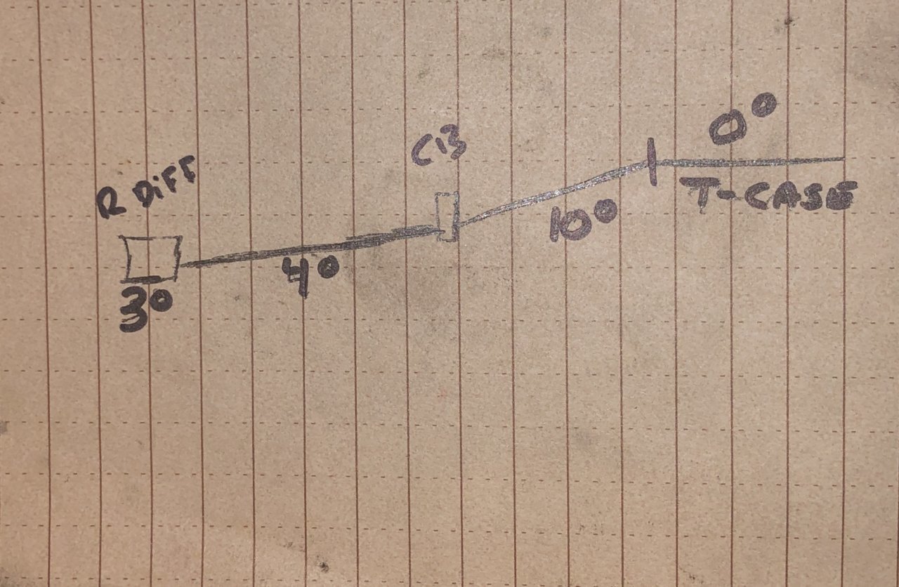

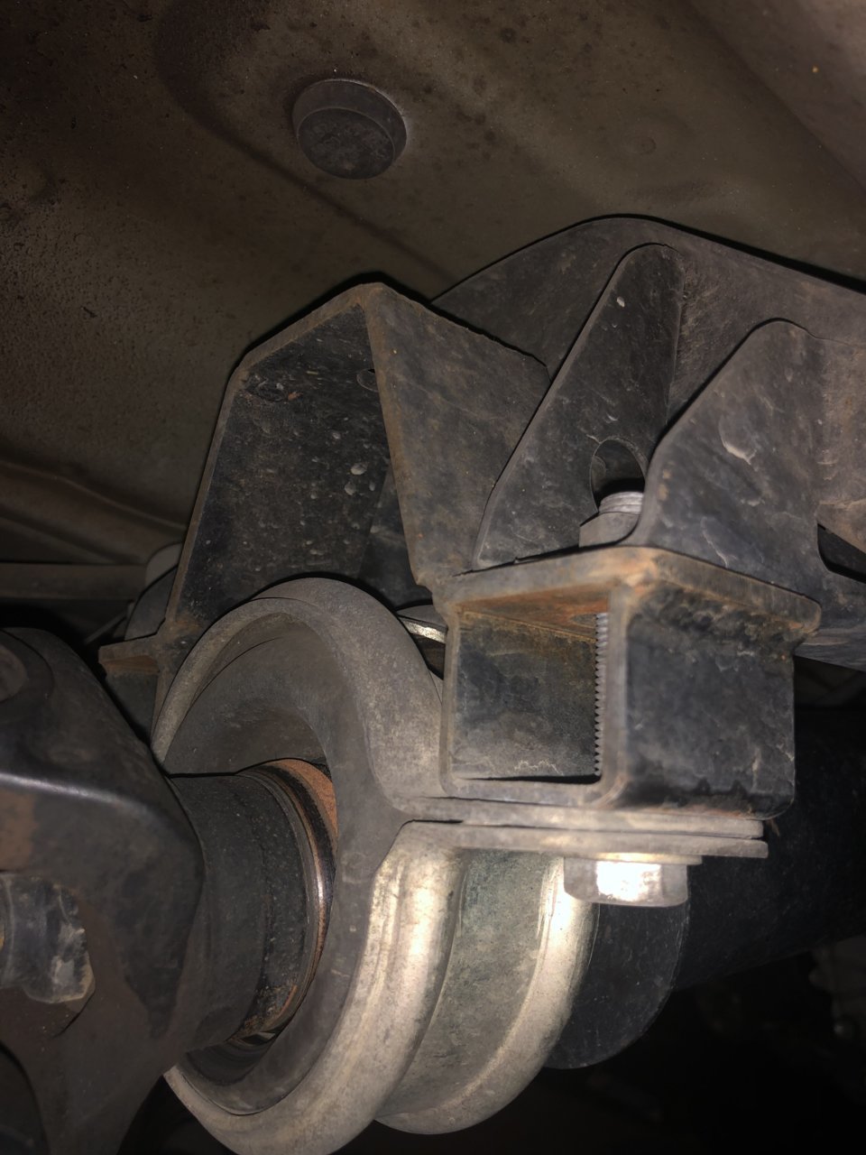

    I think it might be time to remove my Street Tacos CB drop bracket. I used the Measure app in my iPhone to get the following:
    T-case: 0*
    FS: 10*
    AS: 4*
    Diff: 3*
    That front shaft angle seems pretty extreme, and it is forcing the shaft down inside the carrier bearing quite a bit.

    Alright, got under the truck today and pulled out the Street Tacos CB bracket. I also decided to take some measurements with different setups while I was down there.
    "Factory" configuration:
    T-case: 0*
    FS: 3*
    AS: 8*
    Diff: 3*
    OME spacer:
    T-case: 0*
    FS: 4*
    AS: 7*
    Diff: 3*
    OME spacer plus 2 washers:
    T-case: 0*
    FS: 5*
    AS: 7*
    Diff: 3*
    The Measure App on the iPhone doesn't do decimals, which I think why the AS measurement didn't change between OME Spacer and OME Spacer+2Washers (rounding).
    I went with the OME spacer plus 2 washers for now, and I rotated the CB 180*.
    A test drive showed a massive improvement in vibration reduction. Freeway speeds, take off shudder and deceleration shudder (usually between 20-30 MPH) are all nearly gone now. Looking at the difference in angles though, wondering if I should pull the washers? That would put the "T-case to FS" angle difference at 4* and the "diff pinion to AS" angle difference also at 4*.
    Ideally I think a 2* or 3* axle shim to get the diff pinion angle matched to the T-case angle would make it butter-smooth. But for now, this will really help and might keep me from wanting to push it off a cliff......

    I have that app, and can't figure out how to account for the 4 different measurements that need to be made. It only supports 3 measurements, and with the carrier bearing and 2 piece driveshaft, there is no way I can see to make it work.
    It will also automatically "fail" any u-joint angle that exceeds 3*. It is impossible to have no more than 3* for any u-joint in a lifted application on the Tacoma. Hell, the factory angle between t-case and carrier bearing is 3*....
