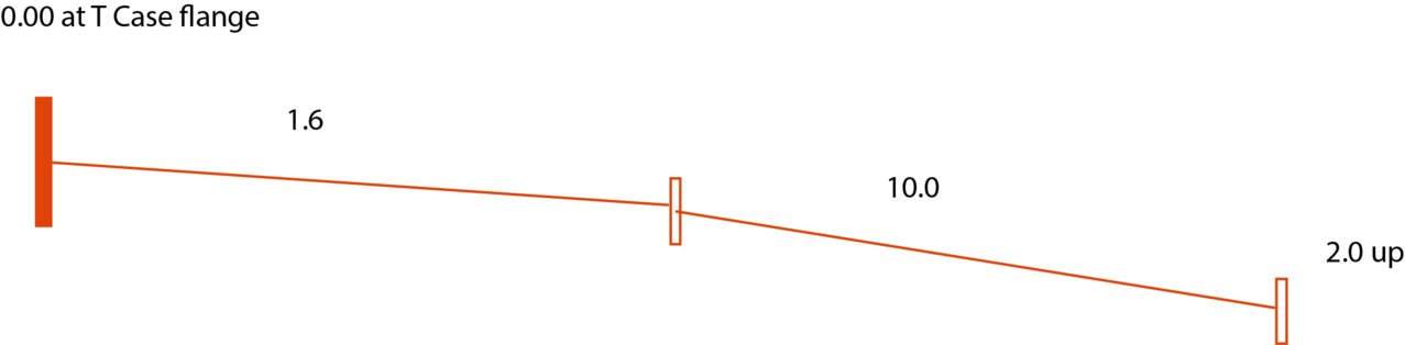

    Trying to get to the bottom of this.. ideally without reading 47 pages! I have read the first few and have to say I am still unclear as to what I need to do... Does the diff pinion flange want to be pointing up from the transfer case flange? Or down... Zeroed out on T case flange I am 2* up which in my mind mean I need to get 2* shims. If someone can simply clarify that would be awesome.
    I hpe my image appears.. not used to this Media gallery thing.

    I know I can do a carrier drop to even out that 1.6 and 10...or at least i hope so..

    There are four different ways to set-up a 2-piece driveshaft.
    Three of them require having zero angle on one of the u-joints and equal angles on the remaining u joints.
    The fourth requires all angles add up to zero. Downward angles are positive; upward angles are negative. Example(2)+(2)+(-4)=0
    You're the fourth...
    (1.6)+(8.4)+(-10)=0
    However, I see you have a '99. If it has a double cardan u-joint, it requires something else. The double cardan is self canceling; the other two u-joints must be equal.

    I have similar questions and will post my numbers later today, but based on what I’ve read I’d start with the carrier bearing. you have an 8.4 angle. Get that to 1 or less (good) and measure again. The tc angle will be more down and you’re pinion angle will be less up, and they’ll be closer together (good)
    here’s what I can’t reconcile. I read that the carrier should be less than 1, and the tc / pinions should be less than 3, BUT the pinion and transfer case should be parallel each other. I have 4 down out of the TC and 4.7 up out of the pinion with the pinion 1 up. If I drop the carrier I’ll be +4 down (bad) and -4 down (good) at the pinion. Shimming the pinion will lower all my angles (good) but I’ll have less of a parallel line from the tc and pinion (bad).
    it also sounds like a lot of trial and error, so as you make an adjustment or 2, you may want to drive / test / assess. Or go TW one piece and forget the carrier ...
