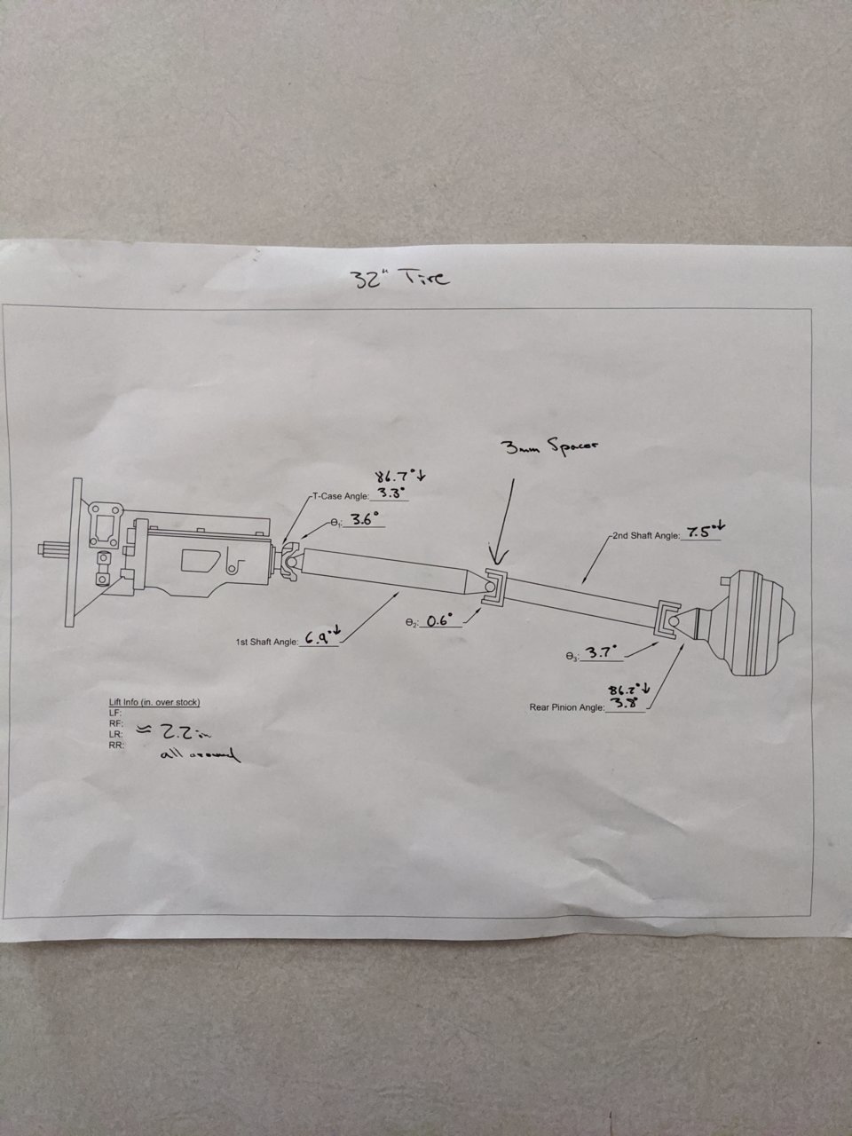

    Alright folks. So I messed with my DS angles this morning and still have vibes from 35-40mph. I even put the stock wheels/tires on and it still vibes.
    Here is what I got after installing 3mm spacers to drop the CB. All the angles seem to be right where they should be, based on my extensive research. Should I try some shims in the rear?

    @nparent2147, you want theta_2 (center u-joint operating angle) and theta_3 (rear u-joint operating angle) to match as close as possible. It looks like some 3 degree shims would get you squared away. If those axle shims overcorrect the angles, you can remove the CB shims to get the working angles closer.

    Hmmm.. yea makes sense. I'm going to remove the spacer and remeasure, spacer never made a difference anyway. Then I might be able to use a lesser degree shim. Thanks!

    With your driveshaft as-is, your center and rear u-joints are 3.1 degrees off. A 3 degree axle shim *should* get you exactly where you need to be.
    That said, your front u-joint is slightly out of spec, so removing the CB shims would help there.

    Removing the CB shim still results in the center and rear working angles to be 3 degrees off. I'll go with a 3 degree shim and see what happens.
