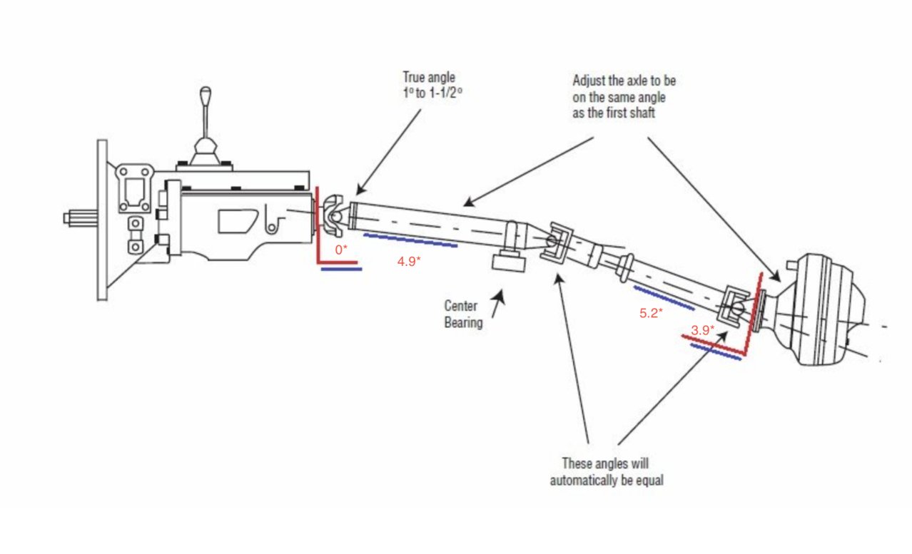

    Hi All, Hoping for some advice on correcting drive shaft vibes. Recently put a Dakar leaf spring in (medium load) along with OME struts and springs up front. Also installed OME carrier bearing spacer kit.
    Within a month or two, I noticed that my rear u joint failed (squeaking quite prominently) and was creating a vibration around 80-90km/h. I removed the driveline, and replaced 2 of the 3 u joints and carrier bearing while I had it out, indexing all contact points to ensure everything stayed aligned. Put everything back together. Squealing gone, but vibrations remained.
    Got an alignment done, tires rebalanced at the same time, but the vibration remained. No sign of a bad wheel bearing (no play) and nothing in the driveline has any slop.
    After spending a good amount of time reading through the forum, particularly this thread, I believe it's a rear diff pinion angle issue. I went ahead and measured angles. Using the flat metal bar from a combination square as a flat surface, i zero'd out an inclinometer on the transfer case pinion flange, and from there got a reading of 4.9 degrees on the front shaft, a reading of 5.2 degrees on the rear shaft and a reading of 3.9 degrees on the rear diff pinion flange. This means a working angle between transfer case and front shaft of 4.9 degrees, a working angle between front and rear shaft of 0.3 degrees, a working angle between rear shaft and rear diff of 1.4 degrees and a difference between transfer case and rear diff of 3.9.
    If I'm understanding everything correctly, in theory, a 4 (3.9) degree pinion shim would resolve my vibration. Is this correct? I've attached an image with my readings to be as clear as possible. To confirm, my numbers are all based off the transfer case pinion reading 0* on the inclinometer. Thanks in advance!

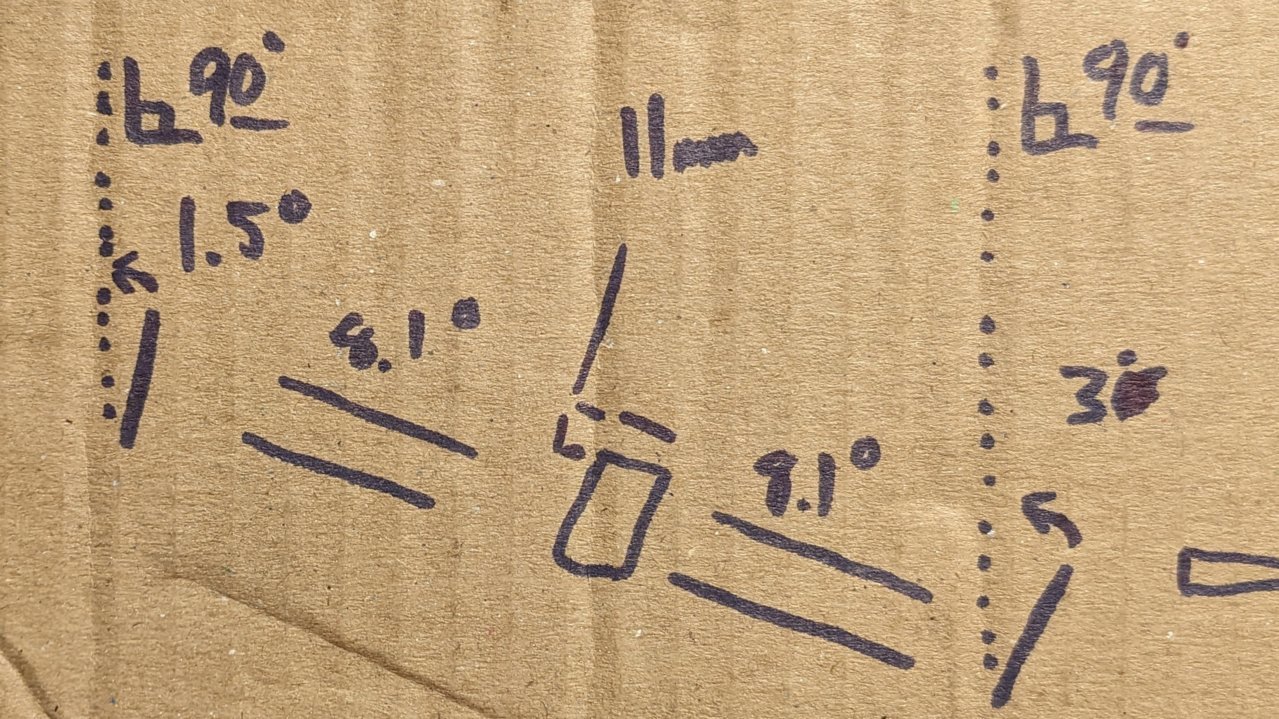

    So here's my measurements following the below methodology;
    Zero'ing at the TC bolt holes surface my first shaft angle is 6.5°, then I have 11mm drop on the carrier bearing, second shaft is 6.8° so my 2 shafts are inline, I then zero'ed the gauge on 2nd shaft and got 4.8° pinion up on the rear axle. (2° in relation to the TC when not zero'ed on 2nd shaft.)
    Compared to the angles I got when zero'ing my Johnson Level Inclinometer off the shop floor I have these angles:
    TC flange 1.5° down, 1st shaft 8.1°, 2nd shaft 8.1° pinion flange 3° up meaning the TC and Diff flanges are within 1.5° of each other at rest, under load the axle would rotate and climb and I assume that's where my vibes are so in theory I need to further angle shim my diff down?
    I currently have 1° shims to point diff pinion down and 4° shims on my bench if I swap those out it should put my diff at 0° down, and under driven torque load it should be within tolerance of parallel to the TC's 1.5° down yes?

    Good news: your data is consistent between both sets of measurements, so the values you already have can probably be used to correct the problem.
    Bad news: your angles are waaay off, and really need to be corrected.
    Taking your numbers and plugging them into my calc sheet:
    ... here's what I'm getting. Correct me if I'm wrong.
    theta_1 - transfer case flange
    - Data set 1 (zeroed on TC): 0.0 degrees
    - Data set 2 (zeroed on floor): 1.5 degrees
    theta_2 - forward half of driveshaft
    - Data set 1 (zeroed on TC): 6.5 degrees
    - Data set 2 (zeroed on floor): 8.1 degrees
    theta_3 - rear half of driveshaft
    - Data set 1 (zeroed on TC): 6.8 degrees
    theta_4 - rear diff flange
    - Data set 1 (zeroed on TC): 6.8 degrees - 4.8 degrees = 2.0 degrees
    - Data set 2 (zeroed on floor): 3.0 degrees
    Using these measurements, you get the following u-joint working angle values.
    delta_1 = | theta_1 - theta_2 | (transfer case u-joint working angle)
    - Acceptable value: =< 0.5 degrees
    - Data set 1: | 0.0 - 6.5 | = 6.5 degrees
    - Data set 2: | 1.5 - 8.1 | = 6.6 degrees
    delta_2 = | theta_2 - theta_3 | (center u-joint working angle)
    - Acceptable value: delta_3 +/- 0.5 degrees, and no greater than 3.0 degrees
    - Data set 1: | 6.5 - 6.8 | = 0.3 degrees
    - Data set 2: | 8.1 - 8.1 | = 0.0 degrees
    delta_3 = | theta_3 - theta_4 | (rear diff u-joint working angle)
    - Acceptable value: delta_2 +/- 0.5 degrees, and no greater than 3.0 degrees
    - Data set 1: | 6.8 - 2.0 | = 4.8 degrees
    - Data set 2: | 8.1 - 3.0 | = 5.1 degrees
    delta_dev = theta_2 - theta_4 (difference between forward half of driveshaft and rear diff flange alignment)
    - Acceptable value: ~ 0 degrees
    - Data set 1: 6.5 - 2.0 = 4.5 degrees
    - Data set 2: 8.1 - 3.0 = 5.1 degrees
    As far as your next step goes... I'm not sure. I would personally remove the carrier bearing drop kit to try and get delta_1 (transfer case u-joint working angle) lower. Hell, flip the carrier bearing if removing the drop kit doesn't do enough.
    Once that's done, then it makes sense to shim the rear diff to reduce delta_dev (rear diff flange matches the new angle of the front half of the driveshaft). Retake measurements and see where that leaves you?

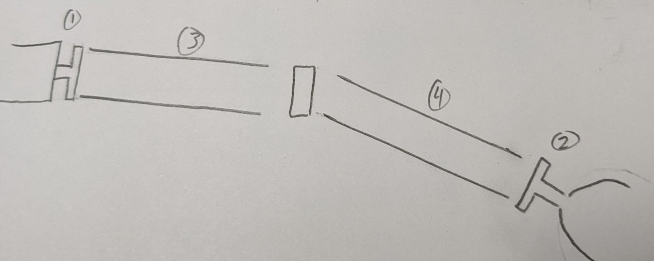

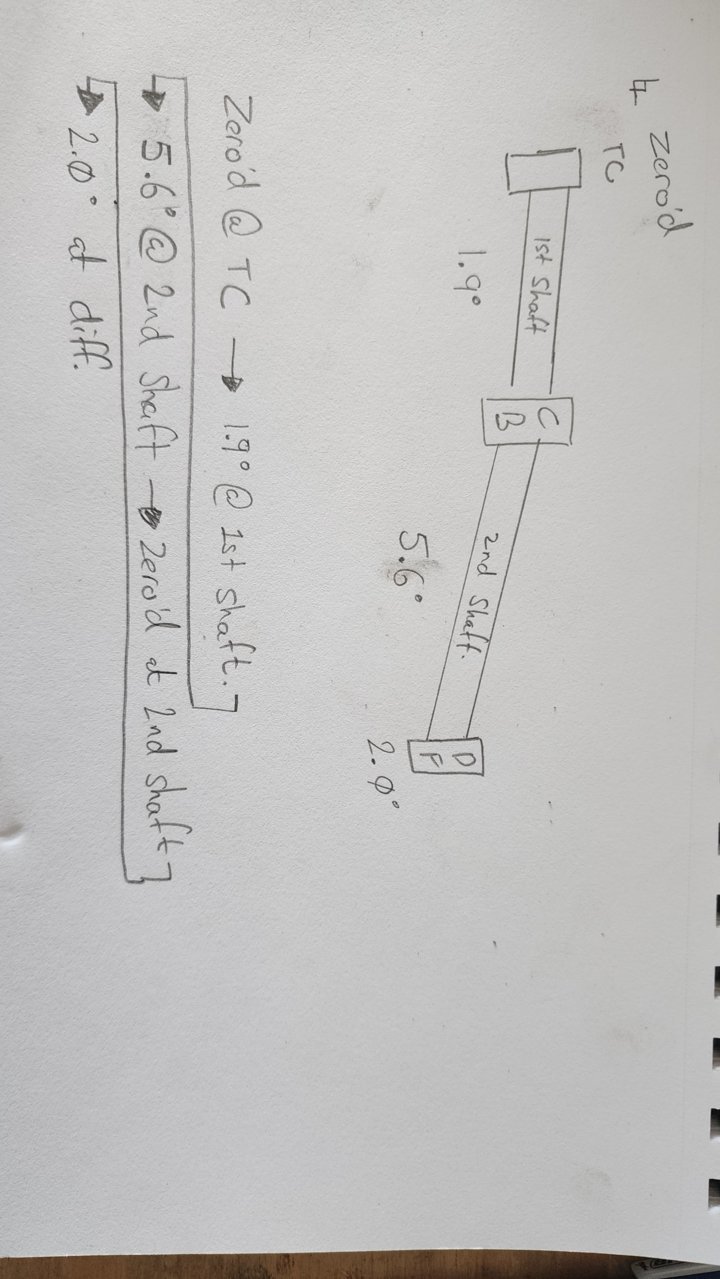

    As a very hands on and visual learner I have provided some quick sketches below:
    My current configuration cardboard sketch somewhat exaggerated to further convey direction of flange tilt.
    I have been so focused on getting the TC and Diff flanges parallel and the first and second shafts inline with each other I was disregarding the assembly as a whole, specifically the flange to shaft angles which is if I understand you correctly why I have vibes even with it setup conventionally correct?
    Disregard the 27.2 and 41.9 those are approximate tape measure measurements from middle side of TC flange to center cap of U joint and from center cap of U joint to middle of diff flange drive shaft measurements.
    So I need to go from:
    Where 1 and 2 are parallel and should cancel and 3 and 4 are inline thus nothing to cancel out to:
    That would reduce the shaft to flange angles but I'm now confused as to how that wouldn't cause vibes being that there's no two points that are equal and opposite to cancel out, shouldn't that generate standing waves as everything is operating at a unique angle?

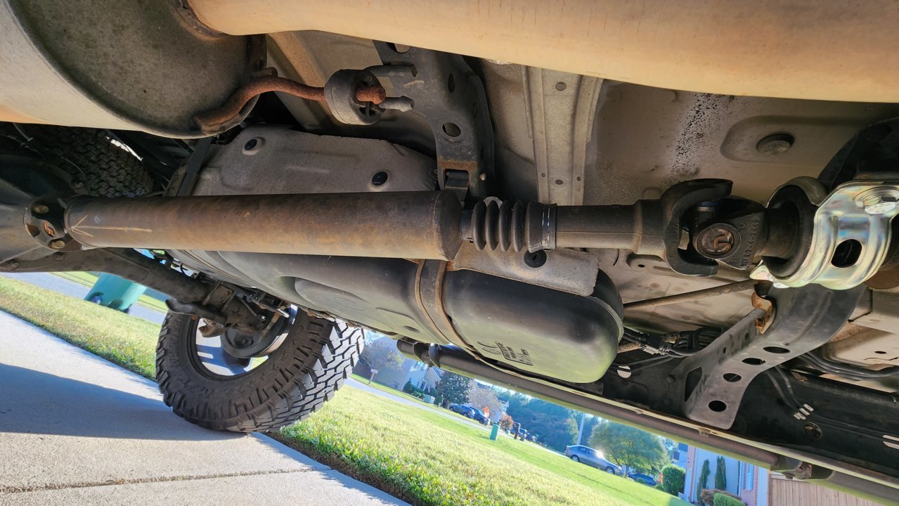

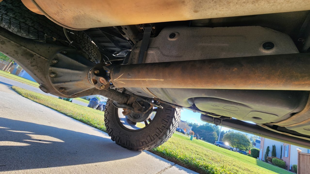

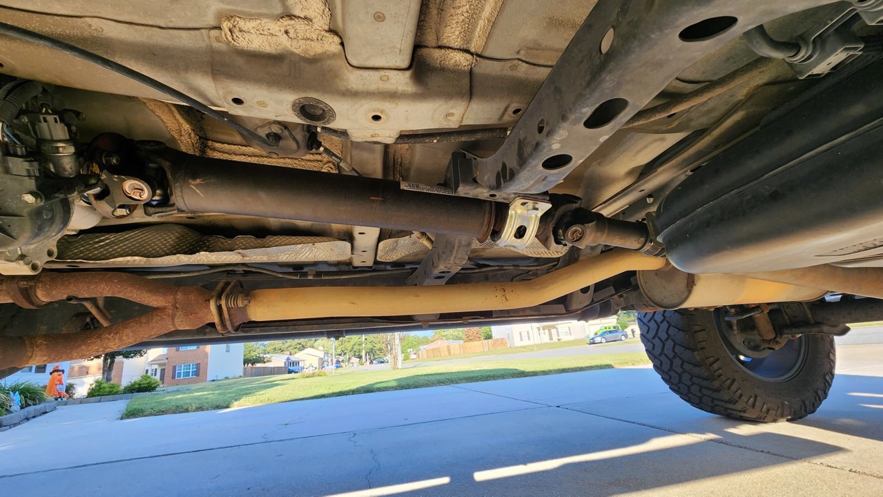

    Last night I crawled under a friend's 3/3 lifted 3rd gen and while he was on a Rough Country block/spacer lift the rear blocks were tapered to point the diff flange up and he had a 5/16 carrier bearing drop and claims no smooth as glass at 80mph which further supports and confirms the theory and what I believe I need to do.
    Found some pictures that may or may not help:

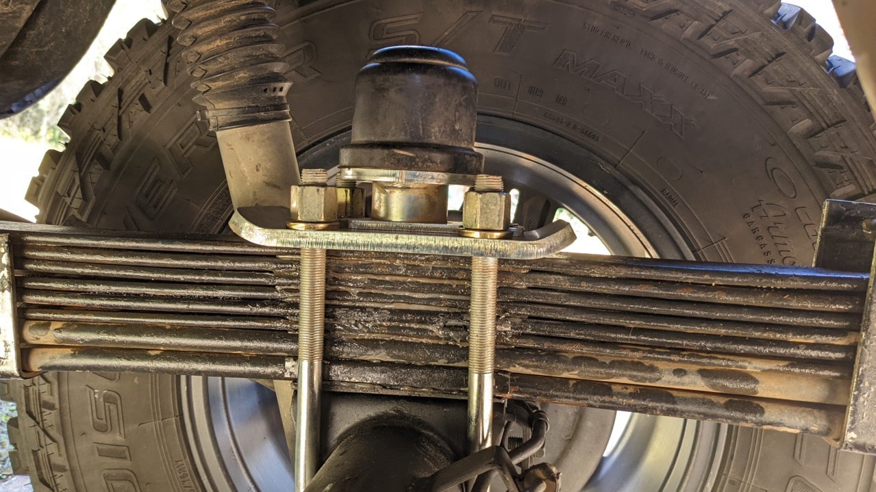

    I currently have 1/8" washers stacked to a 1/2" carrier drop so I'll try going to a 5/16" drop using different washers
    And my current leafs with the 1° shims "fat" end forward.
    So I need to reduce my carrier drop to improve the TC to 1st shaft U joint angle and then install my 4° axle shims to point pinion up to reduce 2nd shaft to diff pinion angle and check and adjust from there, does that sound right?
    Is 4° too much or not enough? I can stack the 1° opposite or the same to make a 3° or 5° if necessary.

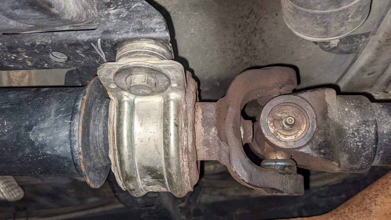

    You may also want to check your center bearing, looks like the rubber portion is beat up.

    As for the center support it's gravy, what you're seeing is the Sikaflex from doing the "urethane injection reinforcement mod" or whatever it's called.
    I just replaced that center support a year ago with new OEM.

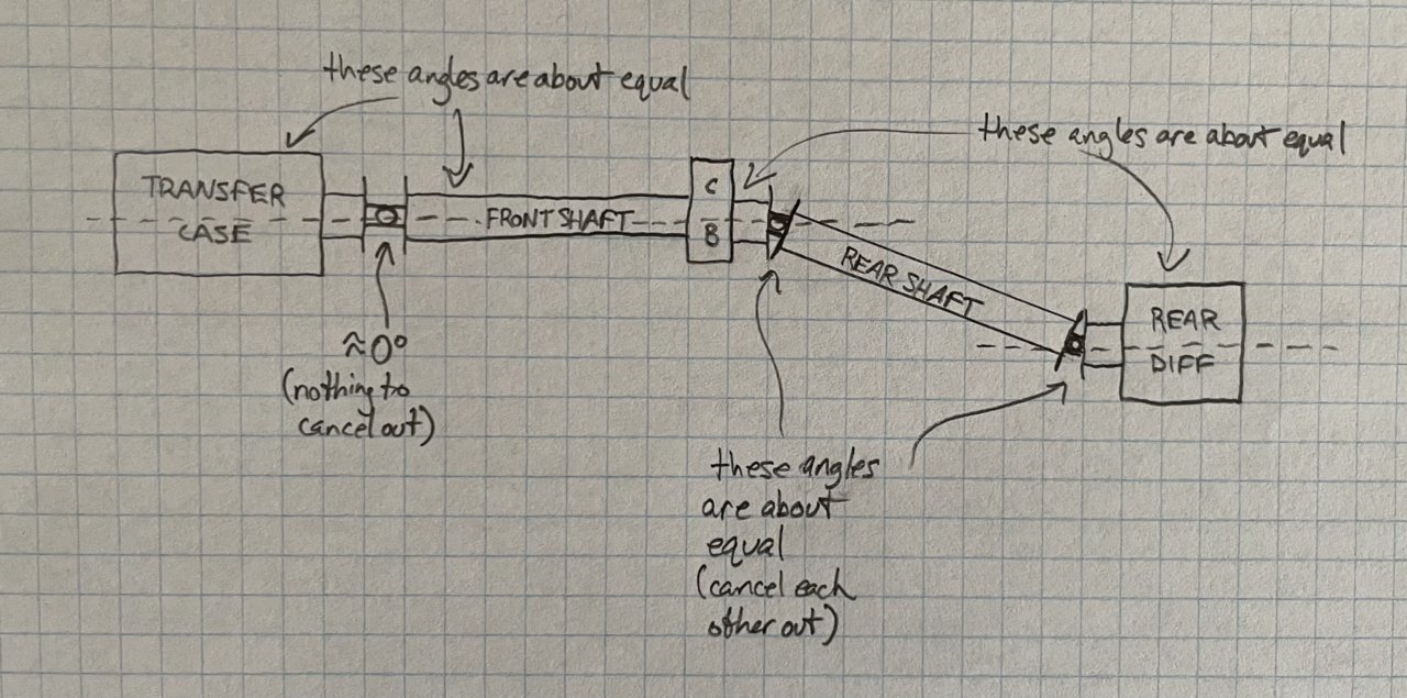

    You're on the right track, with one exception. You want to align the rear diff flange (2) and front driveshaft (3) so they sit at, or close to, the same angle.
    I would yank all carrier support bearing spacers and use that measurement as a baseline. You really want the TC flange and front half of the driveshaft to be in line, or as close as possible. Getting less than 0.5 degrees working angle for the foremost u-joint is unlikely, so don't sweat getting it absolutely perfect. For reference, my truck (DCLB) came stock at ~2 degrees here.
    Yep, that's my recommendation.
    That completely depends on what your measurements tell you, after you remove the carrier bearing drop.
    I honestly have no idea. I can figure out some of the science behind this stuff, but I have almost no experience with the actual hardware. I'm sure some other, more experienced TW folk can give you some pointers here.
    *Edited to add*
    I sketched up a quick illustration to show what I'm talking about.
    Basically, everything is in line except for the rear shaft. That's the desired end state, and it *should* fix the problem. Whether the rear two u-joints are at or below a 3 degree working angle is another matter entirely, but let's get the vibes fixed before we worry about that.
    Disclaimer: I'm not an expert on any of this stuff. I did a ton of research into this topic before getting my own lift installed a couple years ago, but that doesn't make me an authority on driveline dynamics. If I'm putting out bad information, someone please correct me.

    Having problems too. Trying to fix this or somewhat less annoying until I have enough pennies saved for a one piece.
    My set up:
    Bilstein 5100's for the max lift.
    Stock leafs with add a leaf (Previous owners)
    What I've done to fix so far:
    OME CB drop. Doesn't really help
    Replaced all U-joints and CB all OEM.
    Now currently running the CB upside down with out OME spacer. Going to drive it for a few days and see the difference. Right now with the current configuration of the CB both my CB and Diff are less that .2° difference (pretty much same angle)
    Below is my drawing of my angles. If anyone can help calculate coz I'm getting confused lol. Hopefully it's understandable.
    Using the diagram that Key-Rei posted. Here are those angles

    @mchabot1987, are you getting vibrations with these measurements? Just by eyeballing here, everything looks like it should run okay. Angles cancelling each other and whatnot.
    *Edited to add*
    A picture is worth a thousand words:
    mchabot1987 likes this.

    I saw that diagram and I think mine is very close that that. If I'm even measuring it correctly. I measured it like the image the Key-Rei posted. So I'm hoping it's good for now until I get a Tom woods.
    Well I just flipped the CB today, test drove it a little and seemed better. I'll be driving it like that the rest of the week and see if I notice a difference. I'll post my findings.
    I'm not sure if it's even my drive shaft now to be honest. I get odd vibration here and there when taking off. But while driving it's like a constant light vibe in the area of the CB.
    I've slowly been correcting the previous owners awesome mods so just narrowing thing's down.
    Edit to add: Also forgot I put a 2.5° shim at the rear. A while ago (was a friend of mine so was free 99. Just tried to see if that would help.
