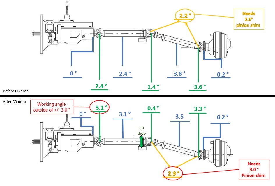

  9. Jul 6, 2023 at 8:49 PM
    #1129
    Potamus
    Potamus Well-Known Member
    Jan 2, 2023
    #414523
    114
    Keith
    Oregon
    2022 Limited Blue Crush Metalic
    2.75 lift on 33s
    before and after CB Drop.
    The carrier bearing drop made it worse, for sure. I’m definitely going to pull it out. I see why some of you are saying to flip the CB, but I’m still thinking a 2.5 degree shim should do the trick with the CB in the stock position.
    Still looking for any solid advice.
    bkhlrTaco's, birry and 33yrsoftoys like this.
