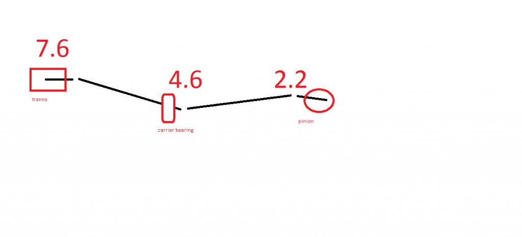

  19. Jan 9, 2013 at 6:45 PM
    #119
    seric007
    seric007 Well-Known Member
    Feb 15, 2012
    #72895
    445
    so below is what my angles look like now with a 1.5" CB Drop.
    i know im going crazy because i swear the steering is getting heavier the lower i go on the CB... or im trying WAYYY to hard to feel shit that isnt ther. :eek:
