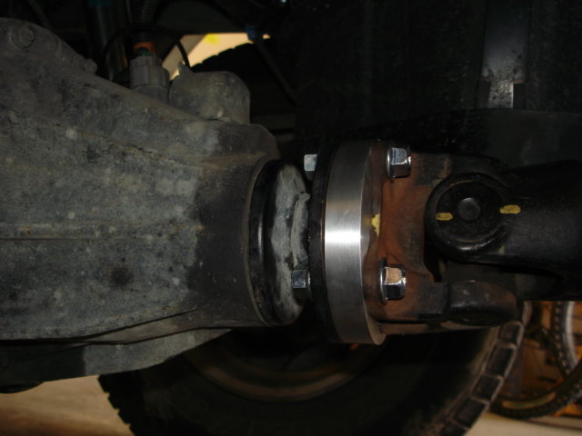

    Does anybody know where to get one of these that will fit a 05-13 Tacoma???

    Huh. That's to lengthen your driveline after a lift????? You PreRunner guys come up with the craziest things...... Educate me, what is that thing? Looks like any machine shop could fab that up for less than $100. Just need the right size hole saw, a drill press, the correct thickness blank stock aluminum, and four bolt holes.

    i can see this being used on 6" + lifts - because you are yanking the yolk out the higher yo go, that could compensate...
    for example i can tell the yolk on the prerunner pics you put up is at LEAST an inch further back then mine at a stop.
    *edit, at least an inch before the drive line mod... i just noticed its a tad shorter and its pulling out a bit more.

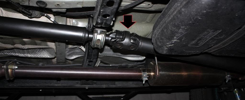

    445
    this is me today :D after being very :mad: until ~ 5pm. the shop started to dick me around... wish i could recommend them... but i cant... so I'll leave it at that.
    got the new shaft (pics incoming got dark on me :() Installed. Mine is also a non-greaseable double cardon.. but it looks quite robust so I'm happy non-the-less.
    slipped er' in and the problem is GONE. FINISHED. KAPUT! I'm also able to run my carrier bearing flipped putting my U joint into tranny at less then 3degree! VERY VERY HAPPY.
    I'm not sure but am i the first prerunner to perform this? Highly recommended. wish i would have done it from the second the problem occured. SHAME ON TOYOTA FOR NOT PUTTING THESE ON FROM THE FACTORY. we wouln't have 100 vibration threads if they did.
    also, on a side note... since the day I've purchased the truck its "shook" at 70+... always thought it was the tires.. GUESS WHAT?! it was the driveshaft.. problem gone... bonus fix!
    :goingcrazy::yay:
    now its :burnrubber: time!
    Edit; screw it took a photo:
    embedded rock likes this.

    ^ Did you just drop it off and say have at it? Or did you give them some measurements? I stopped by a local drive line shop today and they told me that my drive shafts where too short and they wanted to lengthen both of them (front and rear). But I didn't understand why they wanted to lengthen the front one since the length of the transmission to carrier bracket is still the same???And they wanted me to leave my truck upwards of 3 days so they could do it "right". I'm stopping by another shop tomorrow to see what they say. This makes me want to go trade my truck in I'm so fed up with this vibration.

    ^^ Get a photo of what it looks like coming out of the transmission also.
