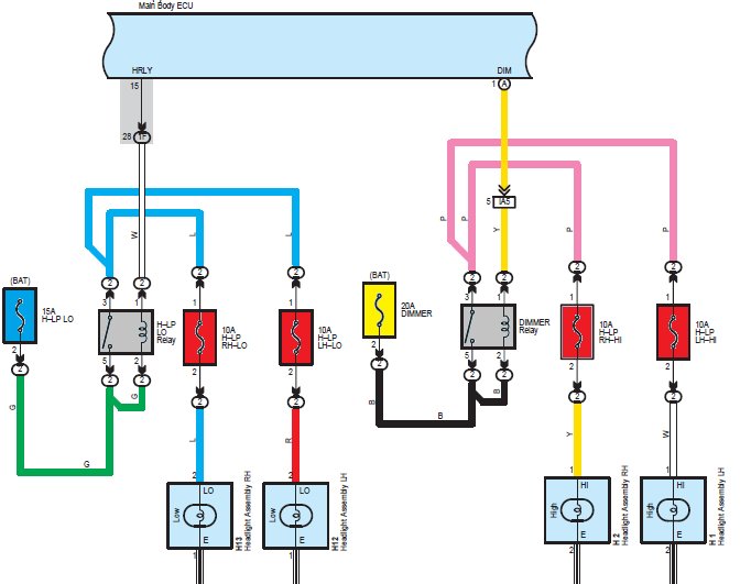

    Main "Hot" fuse for low & high beam, left & right fuses, relays, connectors and wire.
    If only one side turns ON, then wires from relay to connector, these are hidden in the fuse/relay box in engine bay and inside the harness to the headlamps.

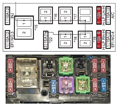

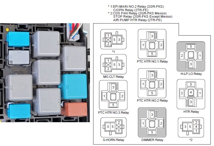

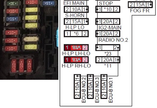

    Great diagrams, added to my growing collection. Thank you.
    Spent a bit this morning going back over my checks, and then I got slapped by a branch on the dumba$$ tree…
    Looking at the fuses, I realized that the two I thought were the individual right side - left side fuses for each low beam were actually the driver side low beam and back-up lights.
    All are 10A fuses, and the passenger side was missing - no idea why (I just bought this truck).
    My mind must have accepted the missing fuse as one of the often-left blank slots for options I don’t have… I mean who just removes a critical fuse?
    At any rate spare 10A fuse installed and PFM, my low beam now works.

    I'm grateful for this thread! Thanks for starting it and for the addition of the wiring schematics & fuse photos and locations.
