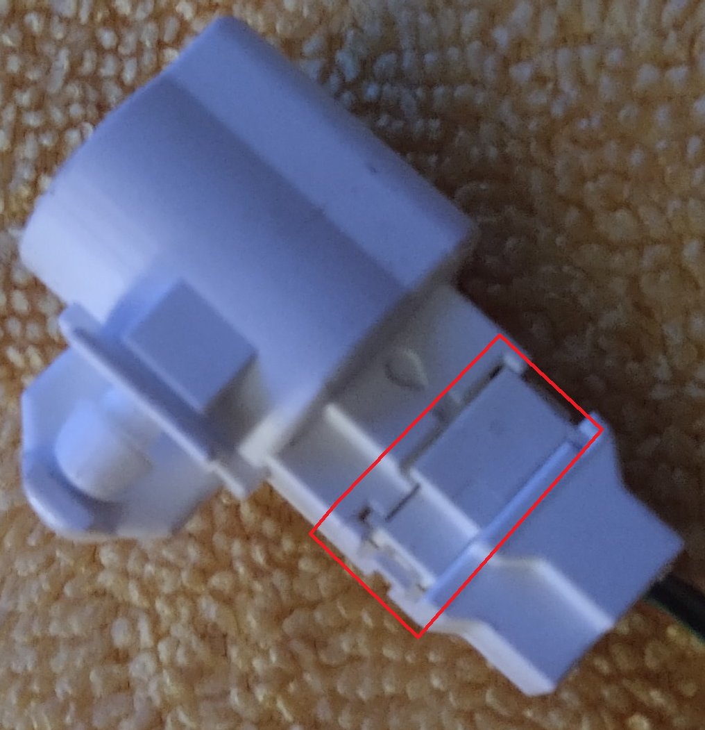

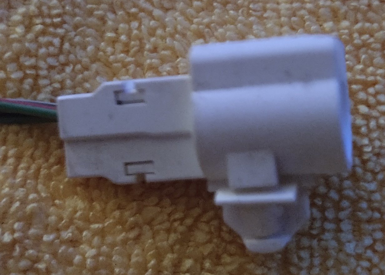

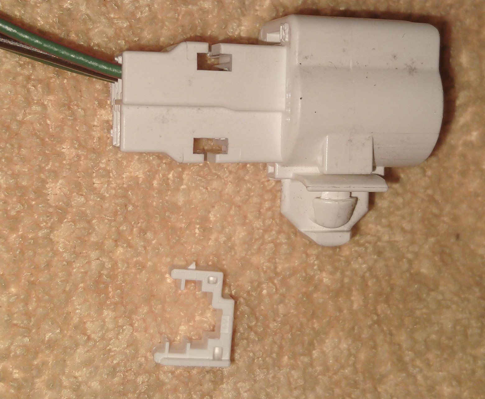

    I'm working on a bit of an oddball project, and was wondering if anyone knows offhand how to depin the male? connector for the driver side mirror. I'll provide a picture below of the connector. I found this thread: https://www.tacomaworld.com/threads/2013-tacoma-side-view-mirror-connector-de-pin.740940/
    Which shows the connector in three pieces, but I can't for the life of me figure out how it comes apart.
    Here is the pictures of the connector:

    See the lock that needs to be removed first?
    After it's removed (without busting it) then disassembly can be done.
    You'll also need a very small flat tool to depress each individual terminal lock in order to remove them. Pay attention how the terminals are facing so you may insert them correctly afterwards.
