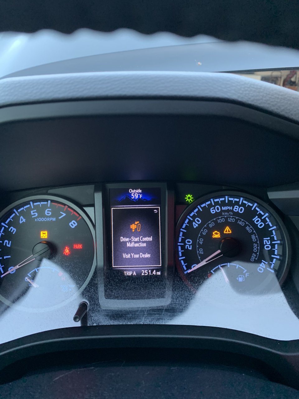

    Bottom line. My truck won't start
    I pulled my truck out of the garage to pull some stuff out and when I went to pull it back in, it won't start.
    The starter turns over but the truck won't catch. It just keeps winding without actually starting. I then get this message.
    If I pull my foot off the break pedal I then get this message.
    So. Other than the obvious, to visit my dealer, is there anything I might be able to do?
    I did try disconnecting the battery for a few minutes and then reconnect to see if it would clear anything. No joy there.
    Anyone else run into this?

    Thanks. I was searching and couldn't find the Drive-Start Control error.
    I should probably clarify. I get the Drive-Start Control malfunction first. The brake error only happens while it's turning over and I lift my foot off the brake.

    The worse thing you can do is DISCONNECT THE BATTERY.
    I can’t understand this.
    When you do it you can and do lose valuable information that a tech can use to help
    Diagnosis the situation.
    Tow it and make sure you tell them YOU DISCONNECTED THE BATTERY.
    It’s a 2019.
    Leave it alone...

    It looks like I'm going to need to have my truck towed to the dealer. We'll see what happens from there. My dealer is closed on Sunday so I probably won't know anything until Monday. It sucks.

    I experienced this episode and dealer had to replace my ecu.

    I got my truck back this evening.
    They said there were some blown fuses. They blamed my USR switchback/turns in my mirror for the blown fuses. I used add-a-fuse for that DRL option.
    They did say it was not warranty but they still took care of it with no charge. I'm not fully convinced that this was the cause. I'm going to leave the DRL option disconnected and hopefully this doesn't happen again.
