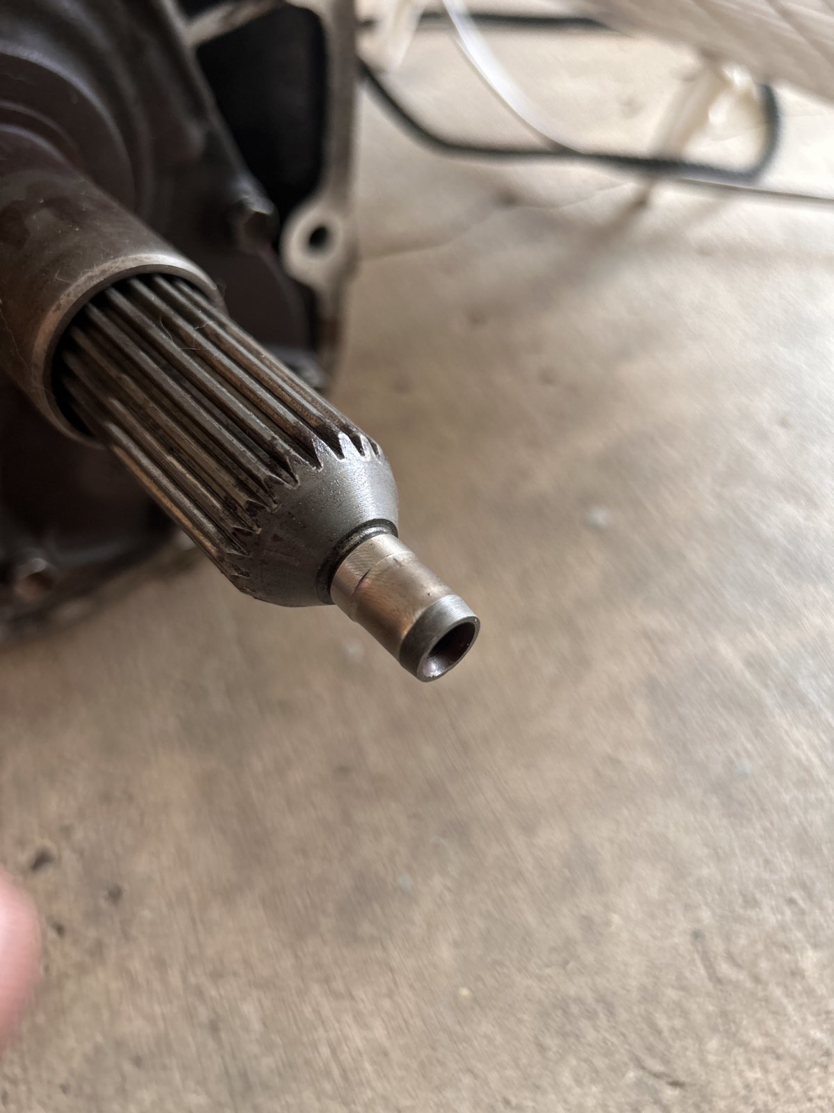

    When I inspected the Transmission
    everything looked pretty good as far as I could see without separating the input and output shafts and really digging in. All the bearings felt smooth and all the shift forks felt great. Also the fluids in the transmission looked great. The only thing I could think of is when I pulled the transmission off I noticed the input shaft where the pilot bearing sits had been slightly worn down and the pilot bearing did not sit firmly on it. I put a new pilot bearing on and sent it because the new pilot bearing seemed to have a little less movement than the old one. Will post pics. I also have talked to a guy with an Auto 2.7 Tacoma with the A340F trans and he seems to be having the same problem.

    I am not sure that is worn. It looks to me like the step is machined, not from wear. You can see the wavy lines across th shaft from the bit chattering on the lathe when it was machined. You notice the area that is a bit yellow? That is where it is contacting the bearing. Notice the wavy marks in the yellow area, just like in the other parts of the shaft? That means virtually no wear. If it had worn material off, it wouldn’t have the wavy lines as they are less than a thou deep. I can make them go away by dragging a file across the part for a few seconds on the lathe. Clearance in the pilot area is generally pretty generous. It can move around a bit without causing issues. The fact that you can make noise sometimes with the clutch engaged, kind of points away from a pilot issue. They usually only present with the clutch disengaged.

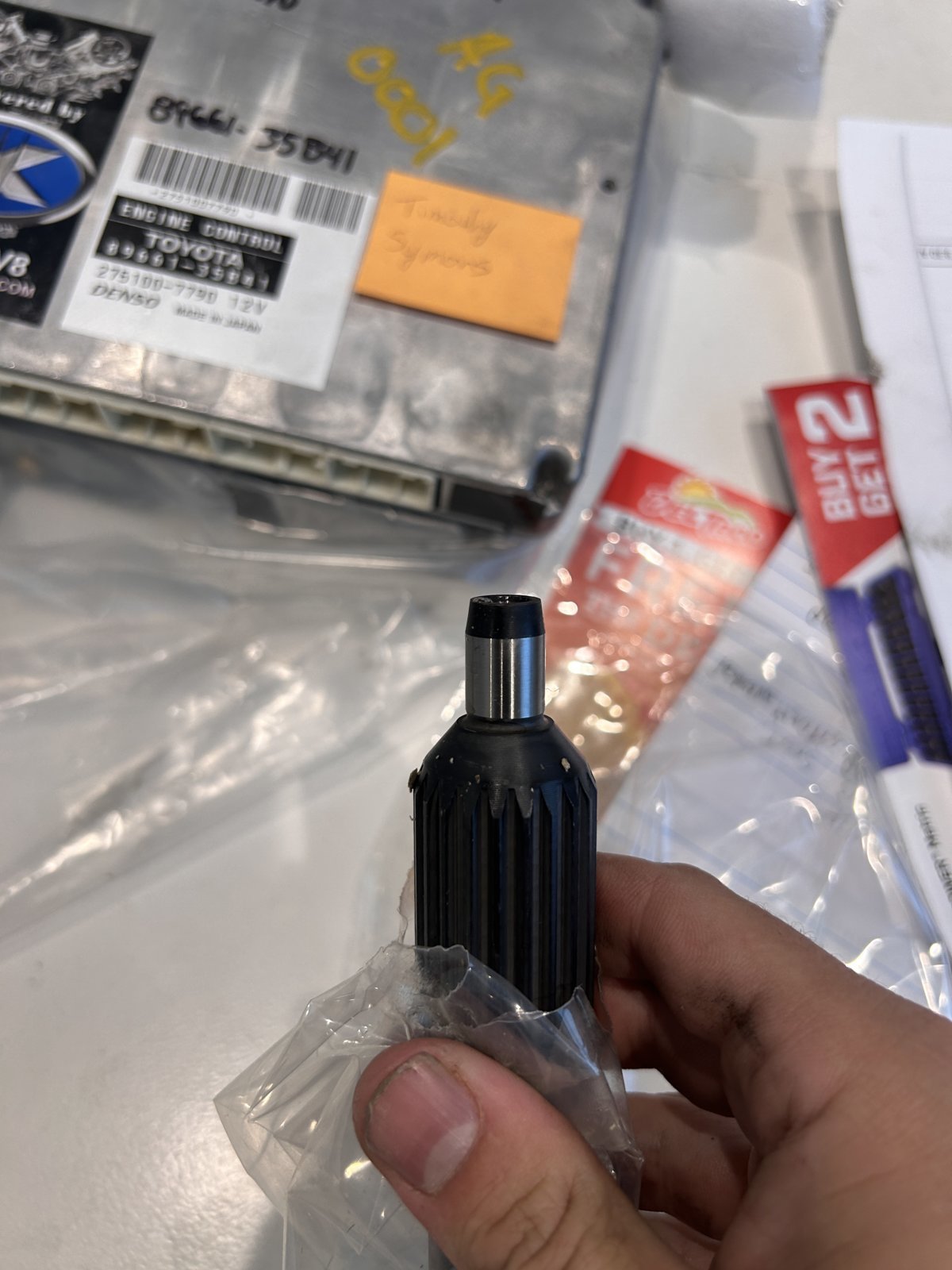

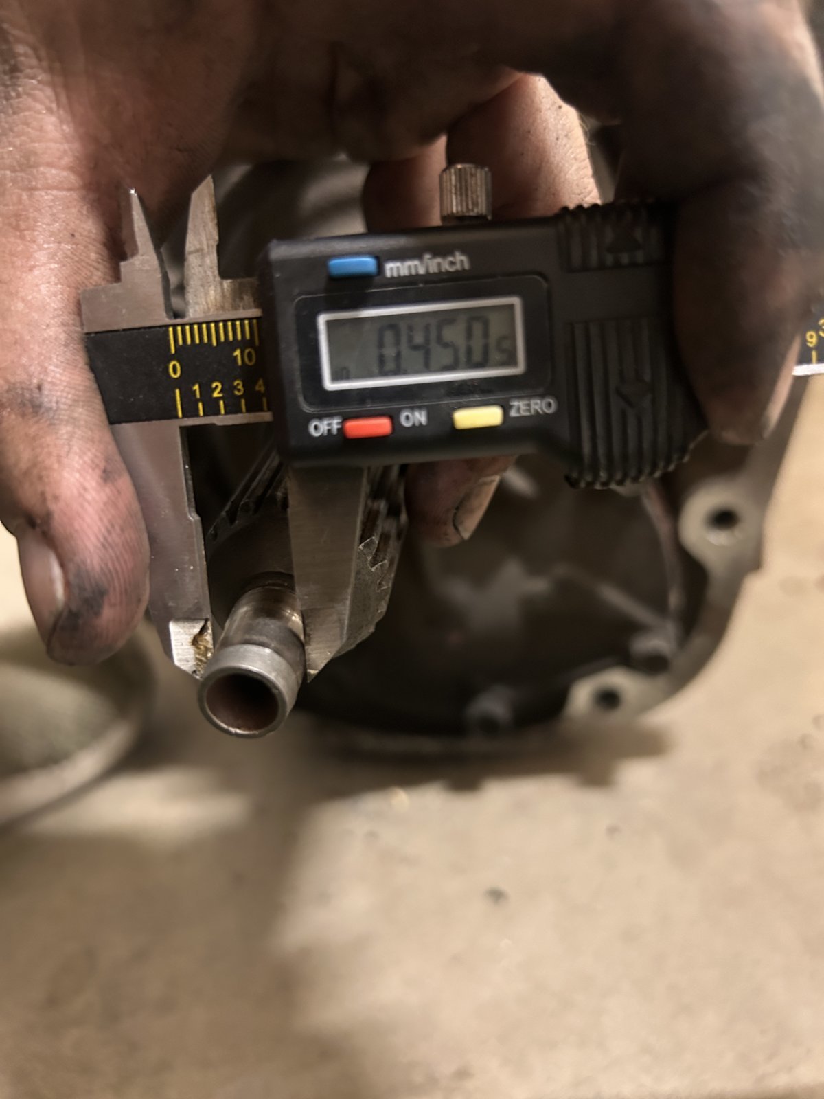

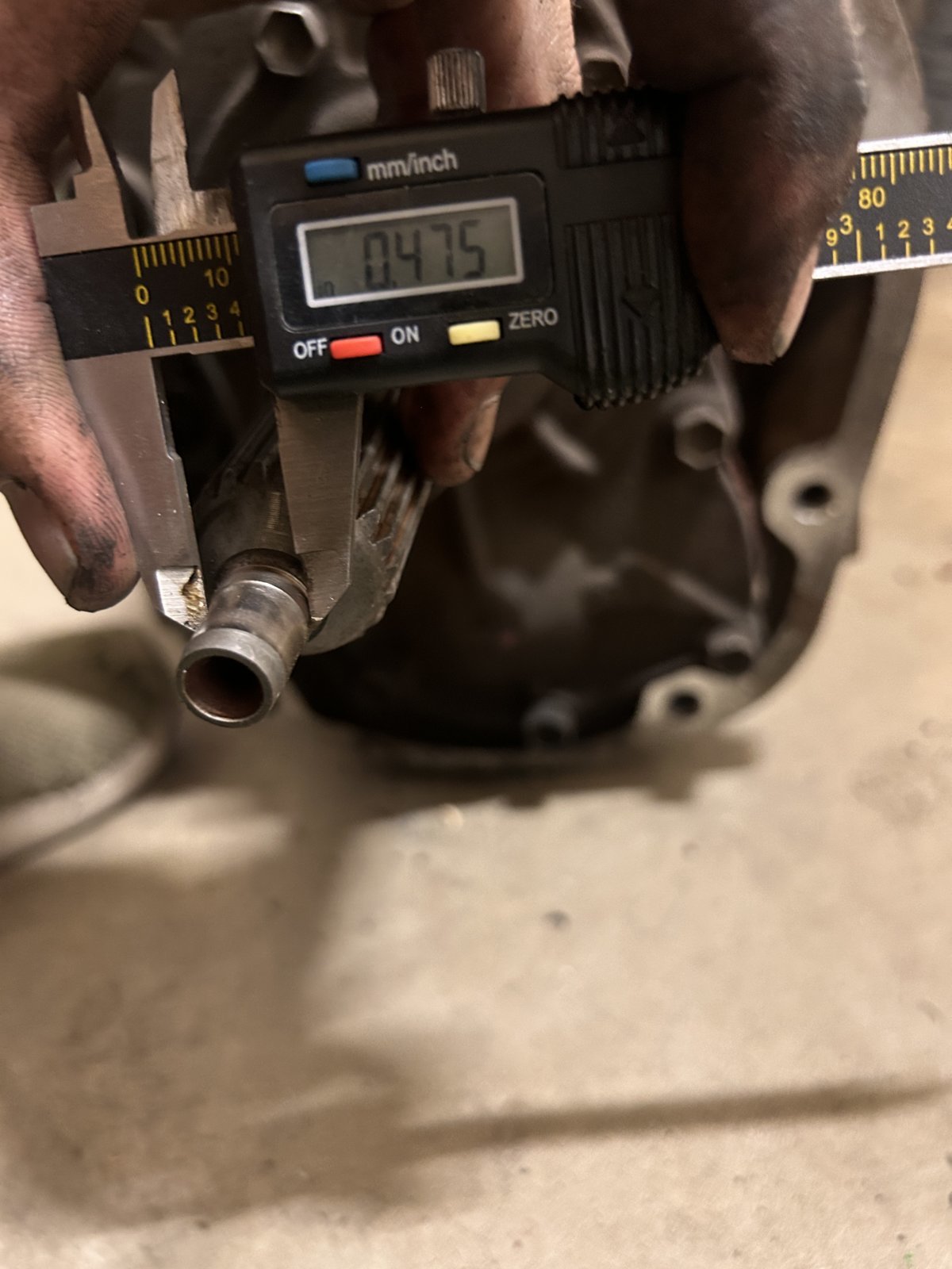

    Update:
    Any input shaft that does not look like this is bad. This is a brand new input shaft from Toyota. They should both be around 0.475inch or so.
    As you can see on mine it has worn through quite badly.
    Mine is bad and the trans is getting rebuilt with Toyota OEM parts.
    This play in the R155F trans input shaft also most likely caused the main input shaft bearing to wear out prematurely causing some up and down play on the shaft support.
    Now don’t jump to conclusions and assume this is your problem. I would highly advise you run through other checks like removing your driveshafts first to isolate it not being the axles.
    When I drained the trans fluid it actually looked ok. Most likely cuz all that noise is coming from the end of the input shaft.
    Feel free to reply and ask questions I’ll do my best to send videos your way or more photos or more on how I diagnosed it.
    Really sucked that I couldn’t find any tech data on if that input shaft is bad or not until I talked to a Toyota guy that’s been doing this for 20years, but sometimes it goes that way.
    So if you have this problem definelty look into it.
    I don’t think the autos have this problem tho.
