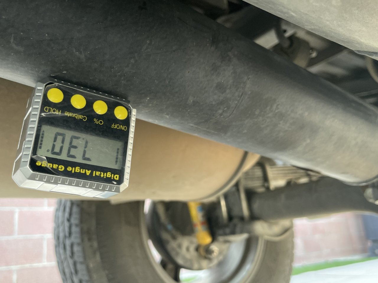

    but you should measure and report back your driveline angles, and see what your operating angles look like. mine are around 4 degrees off. i haven’t had the time to fix my rear end axle shims. i’m hoping it rides like a cadillac after that.

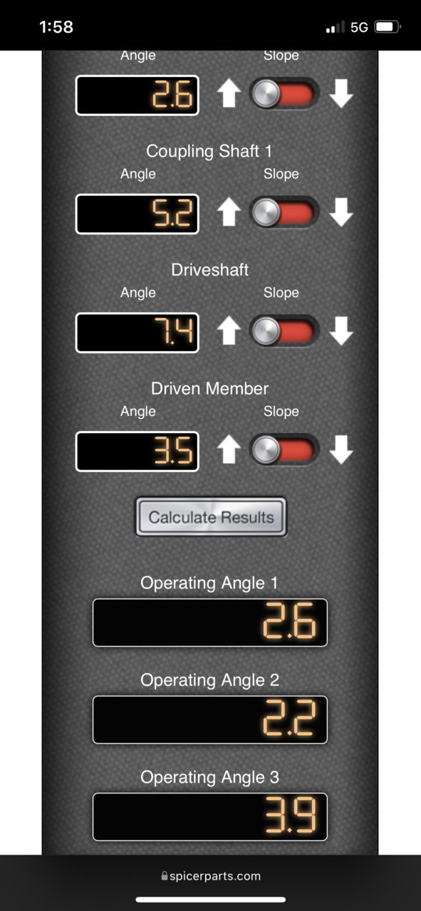

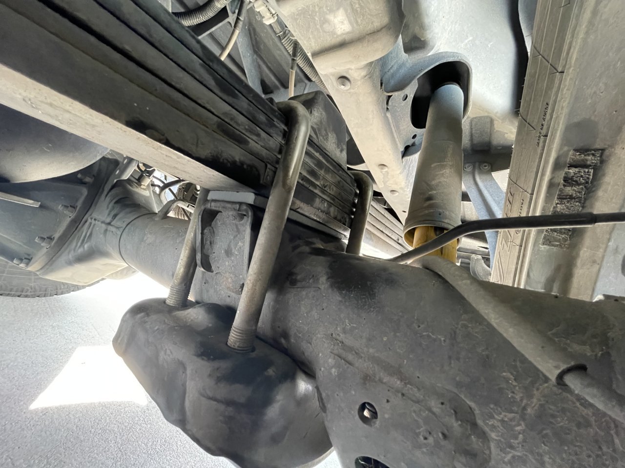

    so i have some updates, i installed what was described to me 2 degree axle shims, meat side forward, rotating the rear end down. my now measurements are refrenced from the center of the frame, out of the transmission, 2.6 degrees. the 1st shaft is 5.2 degrees. the 2nd shaft is 7.4 degrees, and the rear end is at 3.5 degrees. i got some good change. spicer says my operating angels are 2.6, 2.2, 3.9 operating angles.

    14 DoubleCab Sport
    i just checked my notes, and checked the math.. the shim installment changed my rear end angle 2.9 degrees down. from what i measured before and after. i still havent test droven the truck. soon.

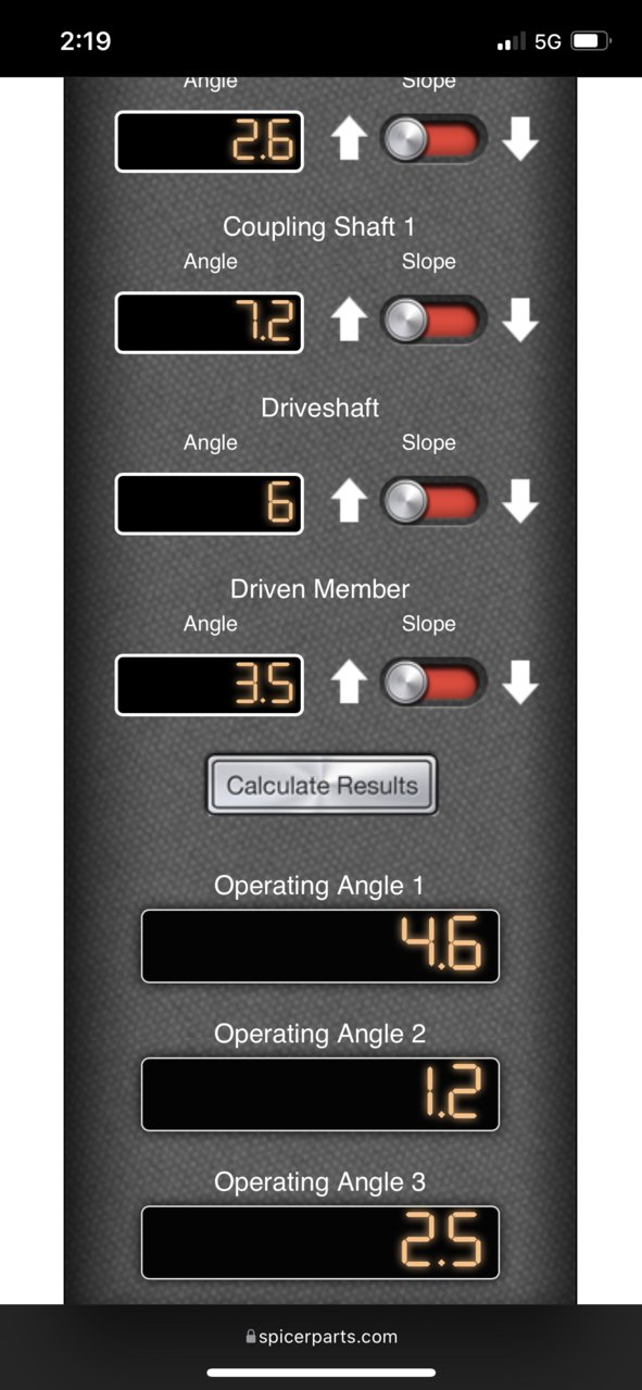

    14 DoubleCab Sport
    i just flipped the carrier bearing back 180, and left my galvinized washer spacer, and now the front shaft 7.2 and rear shaft 6.
    this is now what spicer says...

    Your numbers are very close to mine. I could never get a+b+c to equal 0 , but I could get the angle of the first driveshaft to equal the angle of the rear diff, a method that some say works also. With very similar numbers to you, I have minor vibes 20-25 and 60-65.
    I think our biggest problem is the first operating angle being around 4 degrees. If it were closer to 2, we would have room to drop the carrier bearing. Like you did, I’m going to experiment with flipping the carrier bearing.
    Looking forward to hearing how your test drive goes.

    After installing my 2 degree shim if it doesn’t solve the issue I’m buying a one piece drive shaft. More problem solving and working on it is not worth my time anymore haha.

    Forgot to post back on this. I installed the 2 degree rear shim and have no vibes at any speed. Makes me love the truck again!
