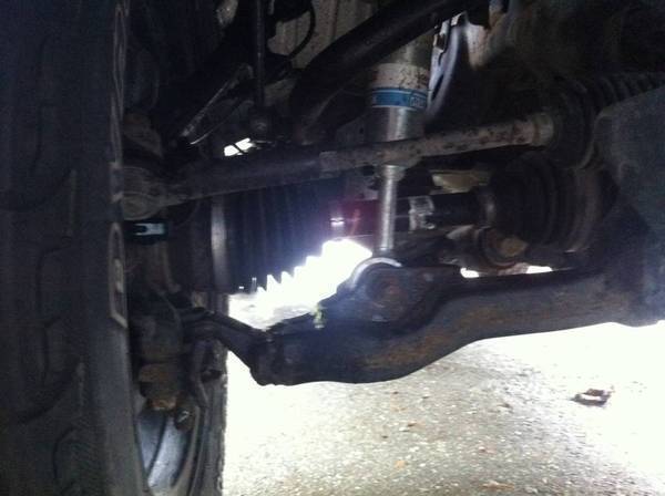

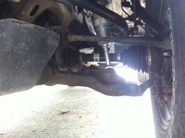

    CV left and right. Looks pretty good to me. I dont see any obvious signs of pulling through the boots and the angles look quite good (correct me if I am wrong or missing something though)

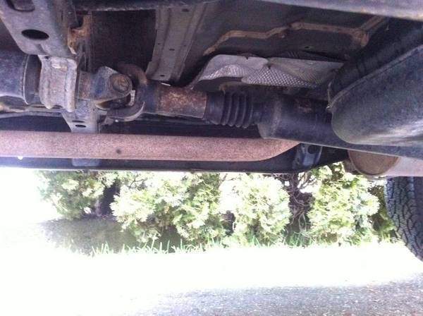

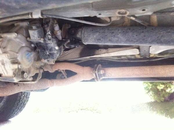

    The driveline coming out of the transfer case. This is the only area that I can think of that will fix the vibes in my situation? Perhaps I am wrong?
    I am fairly sure this is where the CB lives. Like I said, given my situation I can only see lowering this causing me more issues? I plan on spinning the bearing, but also need some advice on where to acccess that. An image of what the bearing looks like in it's housing would be great though, if anyone has one?
    So any helpful hints or advice would be appreciated. As mentioned I plan on spinning the CB around, but am not sure where, or how to access it. I am technically capable to a degree, I just need to know where and how to access it. Help would be great and if anyone sees anything odd in the pics, please let me know.
