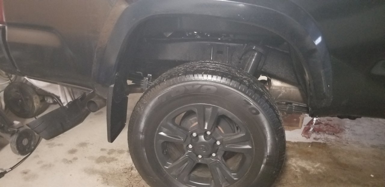

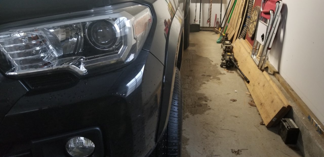

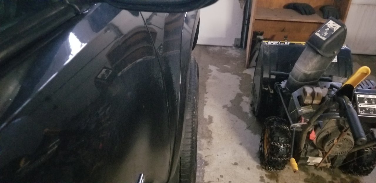

    20190218_163600.jpg 20190218_163541.jpg 20190218_163518.jpg 20190218_163507.jpg
    I went this way because I dont offroad much .now I need to see what size tire I can stuff under there. 265/65/17 looks anorexic..lol

    looks good man, LOL yeah might need a little bigger tire though
