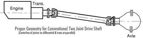

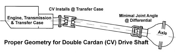

    Hello Guys I have been suffering as well, here is a copy of my email from Tom Wood re a new drive line.
    [FONT=Verdana, Helvetica, Arial]"Please keep the following in mind:
    Vibration problems with the Toyota Tacoma are common even on unmodified vehicles and especially so on those with a lift kit. I wish I had a “one size fits all” solution. The truth of the matter is; we have had mixed results with any version we would send out. Should you purchase one of our drive shaft and it does not meet your expectations, you may return within 30 days for a full, product purchase, refund.
    With that said. We have two options available. A conventional, 2 joint drive shaft or a double cardan (CV) drive shaft. As a general consensus, the conventional two joint seems to work well in most vehicles having up to 3" of lift. In vehicles with greater lifts, the double cardan seems to work best.
    With a conventional two joint drive shaft you need to keep the output of the transfer case & the pinion parallel within 1 degree.
    To use a CV drive shaft, you will want to pitch the differential so that the pinion points directly at the output of the transfer case (maintaining 3 degrees, or less, a joint angle at the differential end).
    The conventional two joint drive shaft is $389.00. The double cardan is $469.00. Once you place the order, your drive shaft will ship the following business day. We pay freight, UPS Ground, Lower 48 States. However we do add on a $10.00 packaging charge. With other delivery areas or shipping methods, there would be additional freight charges.
    If this is something you will want, I will need some measurements per the attached art. Please provide the B &C dimensions on the flange from each end of the drive shaft and a length measurement.
    SEE DIAGRAMS ABOVE
    If you have other questions or would like to place an order, it may be best to call. Our Toll Free US # is 1-877-497-4238. Our worldwide telephone # is 1-801-737-0757. Hours of operation are 8:00 AM - 5:00 PM. Mountain Time Zone. (GMT - 7 hours) Monday through Friday."
    Thank you,
    Tom Wood
    Tom Wood's Custom Drive Shafts Inc.[/FONT]
