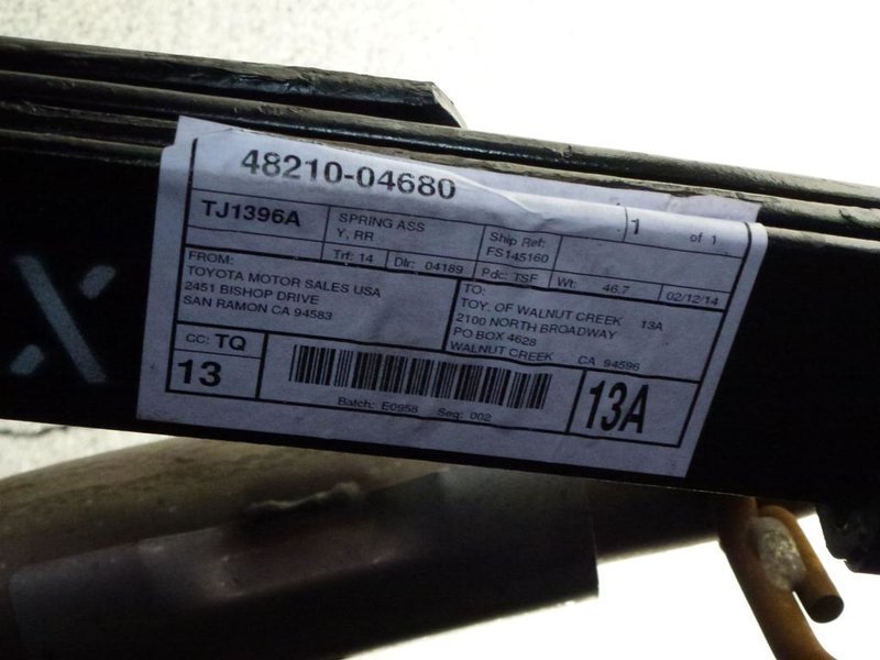

    Part numbers:
    48220-04320
    48210-04680
