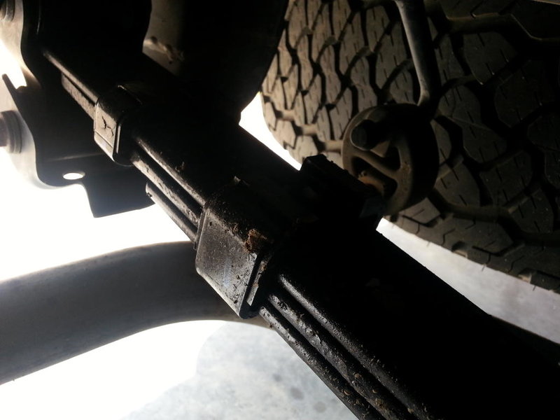

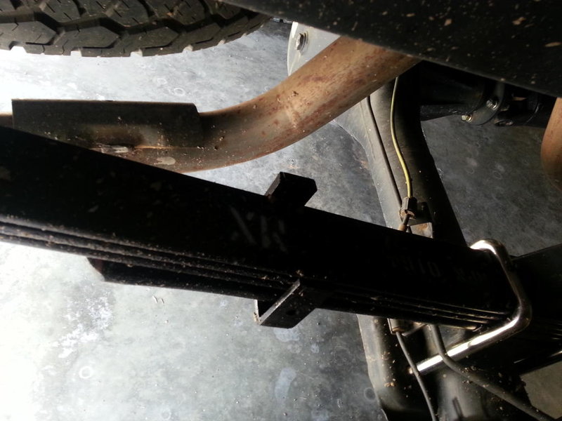

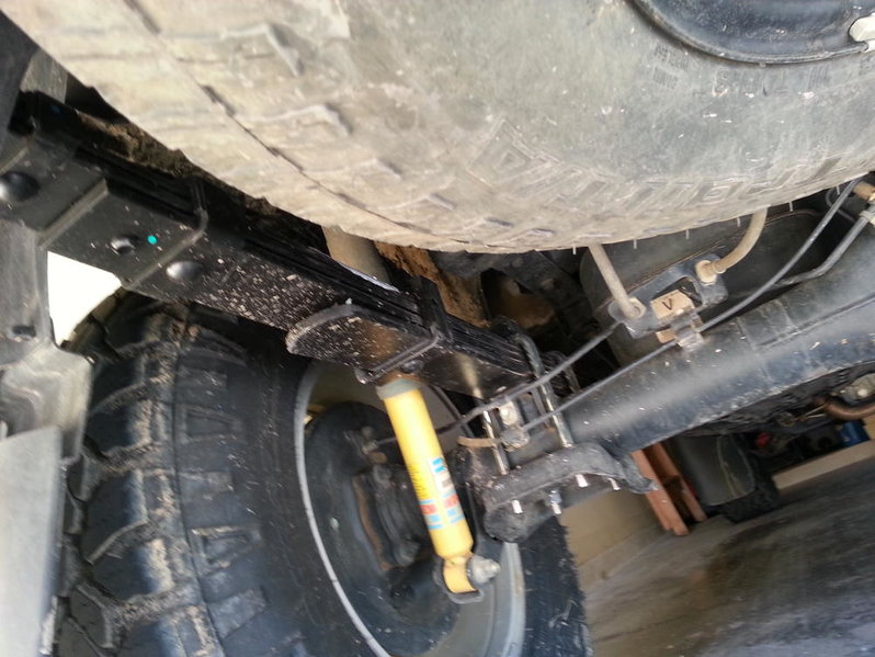

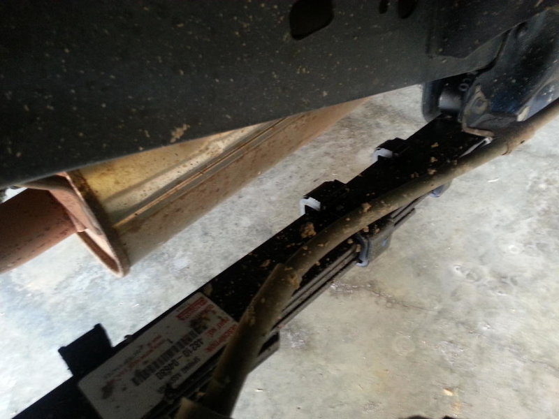

    KaPantsKey, chas44, rainmn, Can you help with a huge favor? Can any of you take a couple of pics of your new leafs and post them? I am interested to see a good view of the ends of the spring, and especially the ends of the overload leaf. A side view might be cool too if possible. Thanks so much for your consideration!

    I'll go out now and try to snap a few pics with my phone.....
  12. Mar 8, 2014 at 11:23 AM
    #772
    MudFlap
    MudFlap Well-Known Member
    Jul 13, 2011
    #59794
    518
    Tim
    Memphis (north mississippi)
    2012 TRD Off Road
    Not the best pics, let me know if you need more detail......
