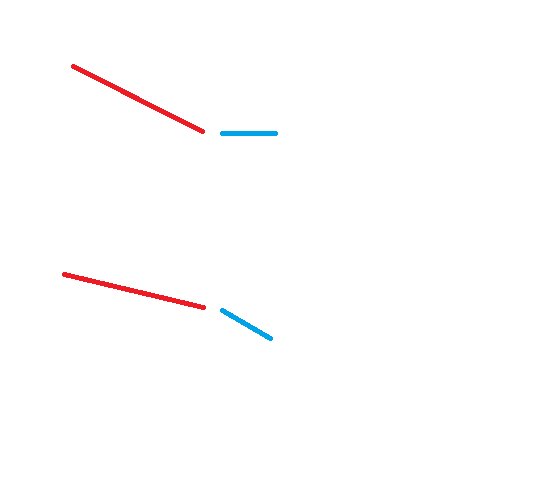

    what is the config on your truck, DCLB, DCSB or AC? prerunner or 4x4?
    Also that angle you measured referencing the picture below (Red being driveshaft blue being pinion)
    Was the angle of the u joint like the top or bottom? (Opening up or opening down)?
  13. May 6, 2014 at 7:32 PM
    #913
    bueller
    bueller Well-Known Member
    Apr 29, 2013
    #103139
    484
    AZ
    DCSB 4x4
    Hard to tell, but it apprears as though it's like the top pic.
    EDIT: the pinion is angled up but is angled a tad lower than the shaft if that makes sense

    Then that would be a positive angle.... If the drive shaft is angled up from the pinion.... It is not a negative. The other dealer was mistaken ... Figures.
    Have the dealer order the 4 leaf pack with the 2 degree wedge.
