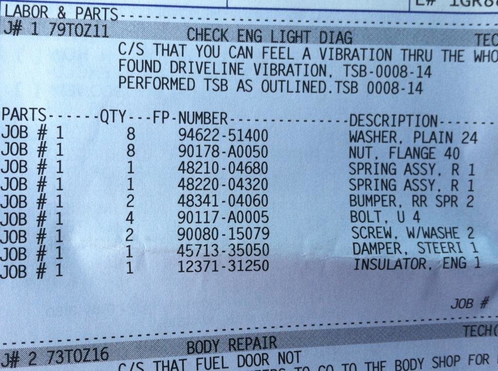

    Got mine done this past weekend. I'd say it's 90% better.
    Zero vibrations on acceleration which is great, I can actually get on the gas now without the whole rear end shaking.
    I'm now feeling slight vibrations between 15-20 under deceleration or light braking, seems like I can feel it a little more when turning at that speed.
    Overall I think i'm happy with it, but the TSB is no cure like the majority of others have said. The dealer also installed a steering dampener which I think was intended to hide these new, less noticeable vibes.
    Anyone bring their truck back after the TSB and complain about the new vibes? Did they have a fix for it or just say live with it?

    I noticed others have mentioned a transmission drop kit? Is there a way I can check myself and see if it's on there? I didn't see it on the list of parts the installed.

    I think the tranny mount is technically called the "engine insulator." Looks like a little Y shaped bracket. Am I wrong on this?

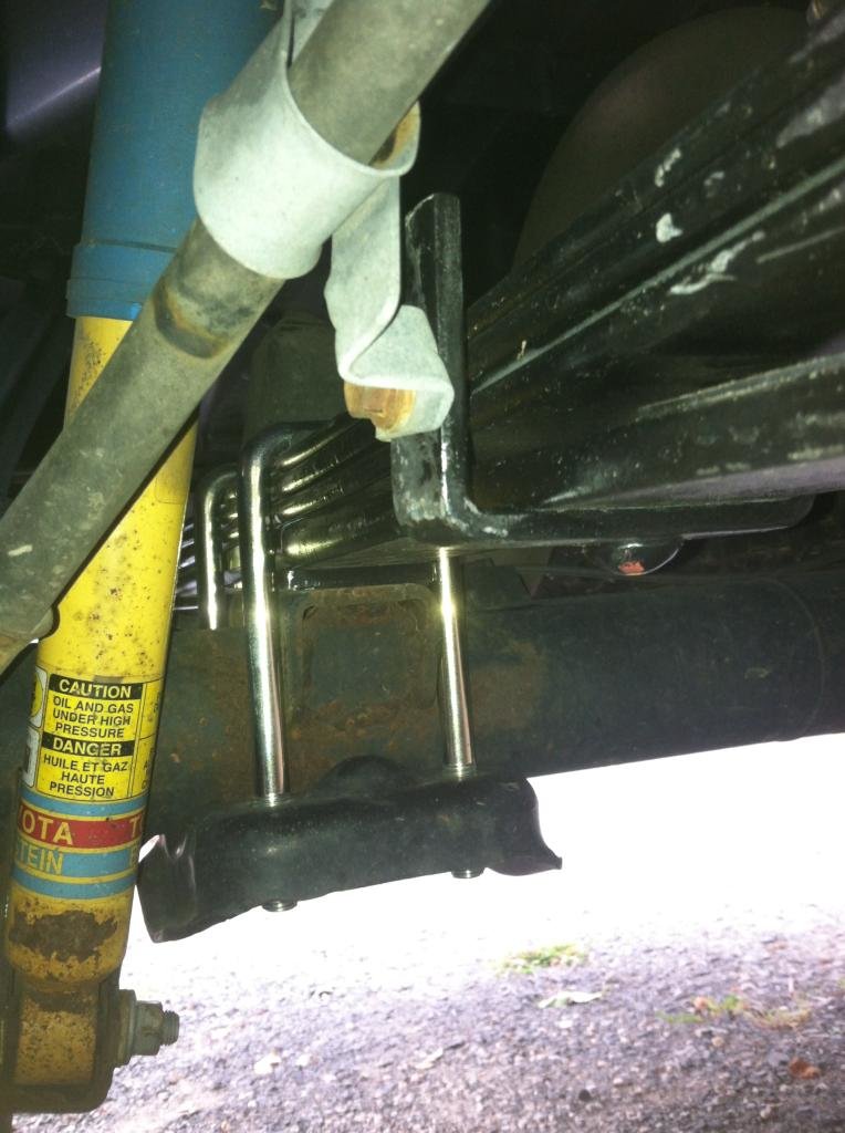

    I looked at mine up close yesterday and the dealer did put the new tranny mount (engine insulator) and the shims under the leaf packs. Along with the steering dampener I think I have just about all the "fixes" there are

    Right: The TSB first page calls to "R & R Engine Mount' but 5 pages later it's an 'insulator.' See Pic.
