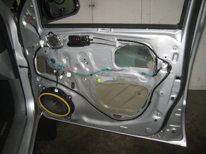

    It's a plastic film right behind the door panel trim.
    Sometimes the window wipers (rubber felt stuff at the top) or the channel below doesn't catch all the water and makes its way down the inside of the door panel and eventually out of the drain holes on the bottom. But some moisture remains inside the door and this plastic sheet/film helps keep that humid moisture filled out of the truck.

    Ahhh yes the plastic that is usually lined with that
    black silicone-ish goop that helps it stick right?

    This picture might help.
    MPOW33R[OP] likes this.
