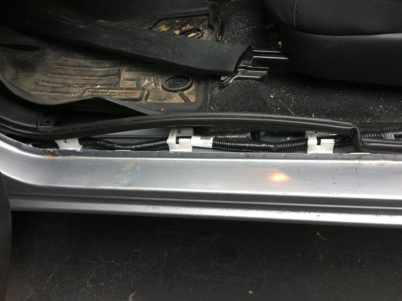

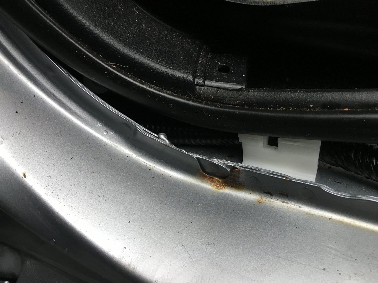

    Same problem on my 2016. Toyota is not supporting warranty but Discovered more by removing the sill molding and gasket. Back at Toyota So far no support hoping they change their position.

    I had a 2005 for 11 years and never rust on body!! Frame was replaced though!! It appears on the 2016 to be trapping water in the gasket and it runs down to the bottom and pools there. If you see signs pull off the molding piece the lift the gasket and inspect the area

    OK Update.... Just got factory approval on the rust repair. They originally rejected it until spots were discovered under the weather seal.

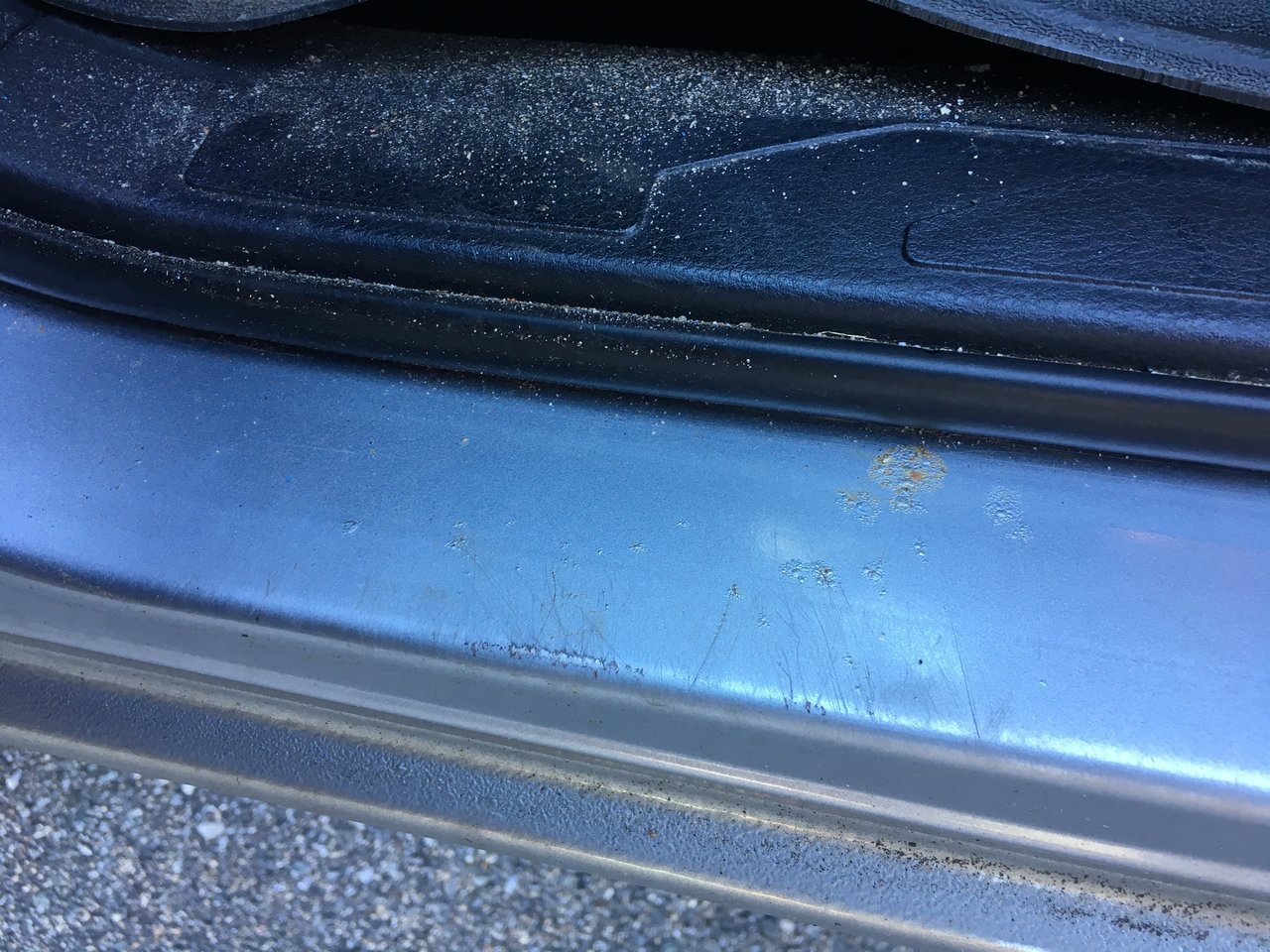

    Same thing happening to my 16. Very little winter use. Will see how this plays out myself. DB158F26-1BF1-4AA0-B68F-9D7E14D53FAF.jpg

    I would suggest all owners pull the sill cover then also lift the weather stripping It appears to be trapping moisture. Good Luck!

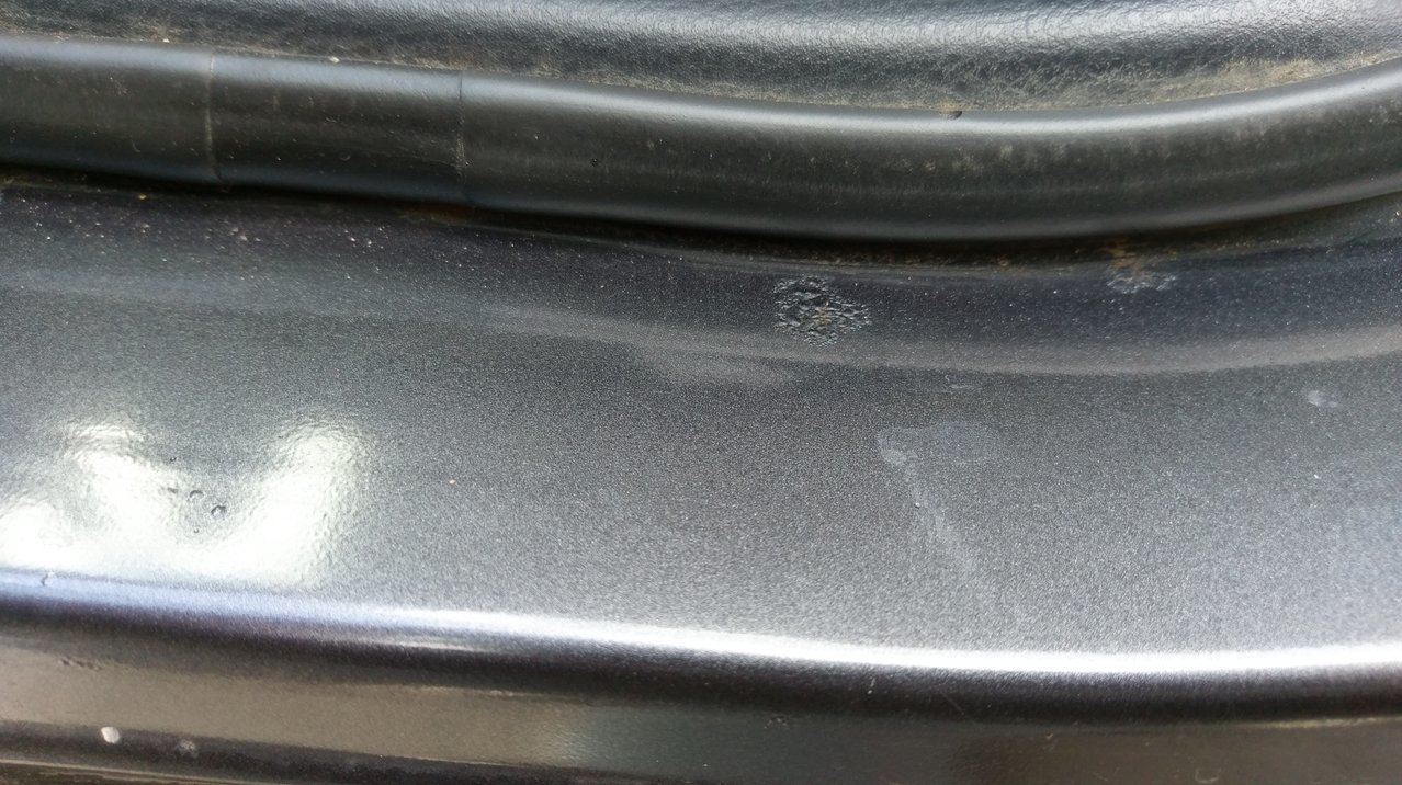

    I can't believe I didn't update this. Took my dealer a few months to get it into the show. Once they got it torn apart and were able to look at it more closely they found the truck wasn't rusting, it was just something that got in the paint with a little moisture and started seeping through the paint. So they sanded the imperfections away, repainted and it's all good to go!

    @mlatner Thank you for starting this thread. I just pulled my seal and only noticed some rust streaks at the very front of the cab where the three pieces of metal join the spot weld. I was able to clay away the rust streaks and saw no evidence of bubbling, only 1-2 areas where the paint had chipped on the edges of the metal. I doused it in FF will be adding this area to my annual FF regimen.
    You didn't happen to get a glimpse / photos of the sill once the paint was removed but before it was resprayed, right? I'd be curious to see how much of the area was affected.
    @mpoirier61
    What was the resolution for your repair? What did they find? Also, did you have the black stick-on sill protectors, or did you remove them to find the blisters? I'm so conflicted by this bubbling because I've always grown accustomed to bubbling = bad rot, but it seems like it's truly a paint flaw, which is interesting.
