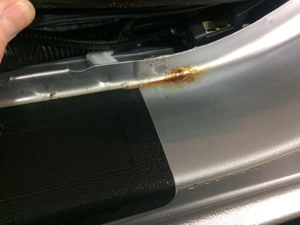

    I worked in automotive for a long time and have seen this before.
    In the picture of the floor you'll notice the corrosion is predominantly in areas where the spot welds are. When you spot weld, you damage remove the zinc/galvanizing on the metal.
    In the pictures where you see the corrosion on the sills you'll notice spot welds above areas where the "spatter" has corroded and bubbled up under the paint. You may notice there is a spot weld with a different shape/contour vs some of the others.
    When you spot weld you have to control the orientation of the weld tip surfaces to the metal being fused, You also have to control tip pressure and amperage during the weld.
    Screw one of those up and base material is "squeezed" out and will spatter on adjoining surfaces, no galvanizing on it so it will rust much easier.
    Sometimes the spatter is only partially attached and some paint/primer flows underneath and so therefore there is an under spec film thickness between the spatter and the environment.
    When you see videos of robots going into the cars and spot welding and you see sparks, remember:
    "Sparks are bad, M'kay"

    In short this is what the body shop manager was assuming had happened.

    This picture is a TEXTBOOK example of what I was saying, looking at the spot welds left to right,
    First two have the inner surface parallel to the welded surface,
    Last on the right you can see that the LH side of the weld is deeper than the RH side, the spatter is on the 4'oclock position to the right,
    Material "blew out" because the tips were not in the correct orientation to the welded surfaces.
    Programmer of that robot just rotated the "head" of the robot to do that third weld and did not reorient the other axis of the robot arm to get a proper orientation.
    There I've almost finished a Toyota "5 Why"....

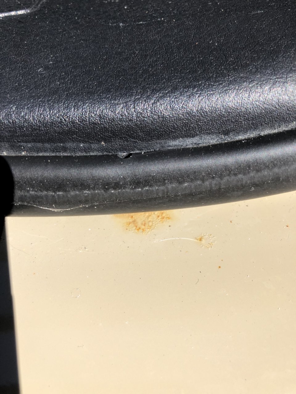

    Former 3G Tacoma owner
    Just checked mine & it also is rusting. This 3rd gen truck is a nightmare of problems. B22993E7-302A-4554-B42B-0FE07ED22667.jpg
  17. Apr 25, 2018 at 2:45 PM
    #57
    shakerhood
    shakerhood Well-Known Member
    Aug 9, 2015
    #161370
    37,136
    Southern Ohio
    2017 MGM DCSB Off Road, 6 Speed MT, P&T
    That does not look good but I am sure they will take care of it under warranty
  18. Apr 26, 2018 at 9:20 AM
    #58
    mlatner
    mlatner [OP] Well-Known Member
    Sep 11, 2016
    #197050
    107
    Michael
    Omaha, NE
    2017 Tacoma OR DCSB
    Stock
    Don't worry too much. That looks exactly like mine did. It's just loose stuff that got under the paint while it was being painted. Not actually part of the body of the truck. Still covered under warranty though.
