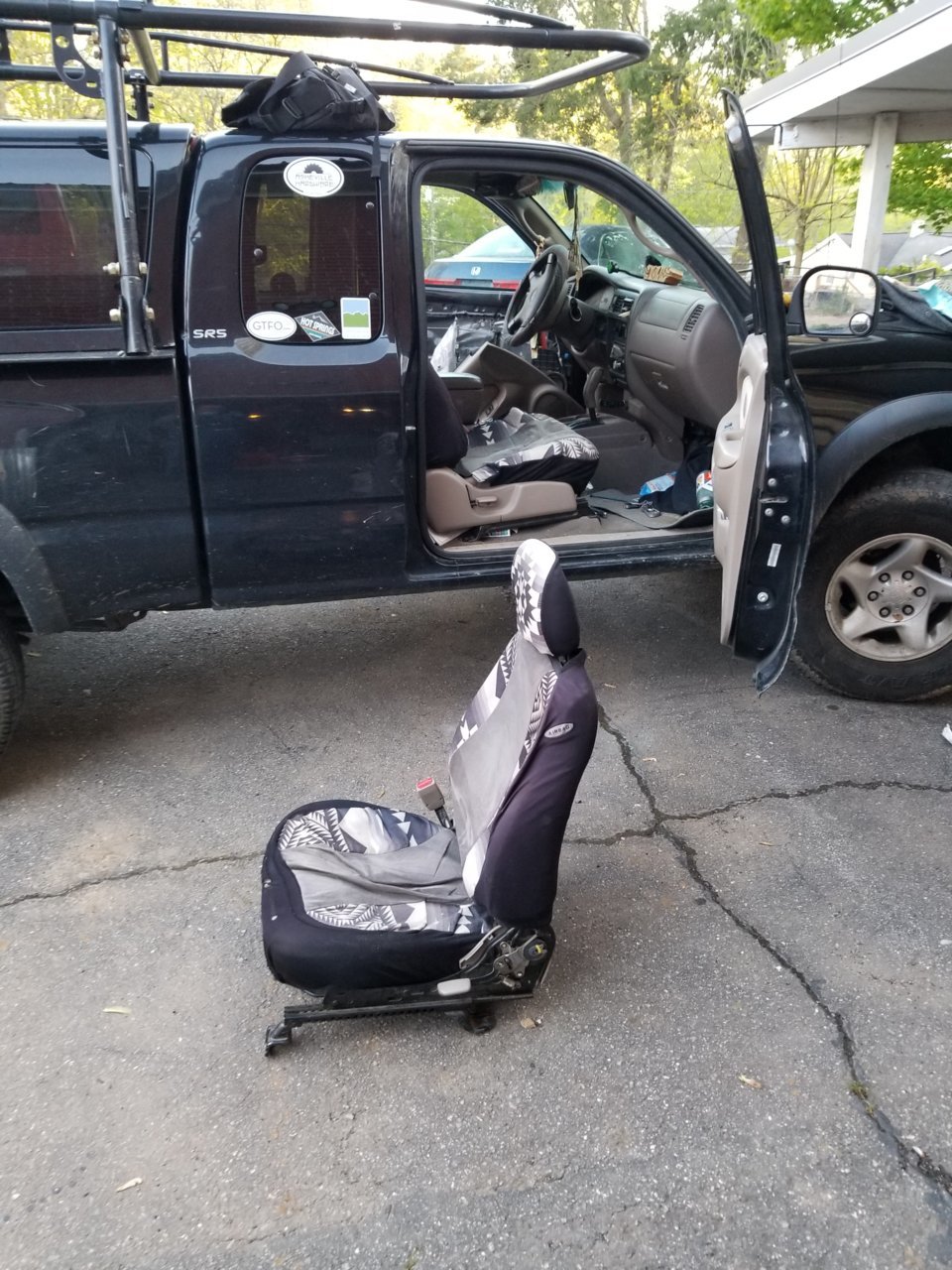

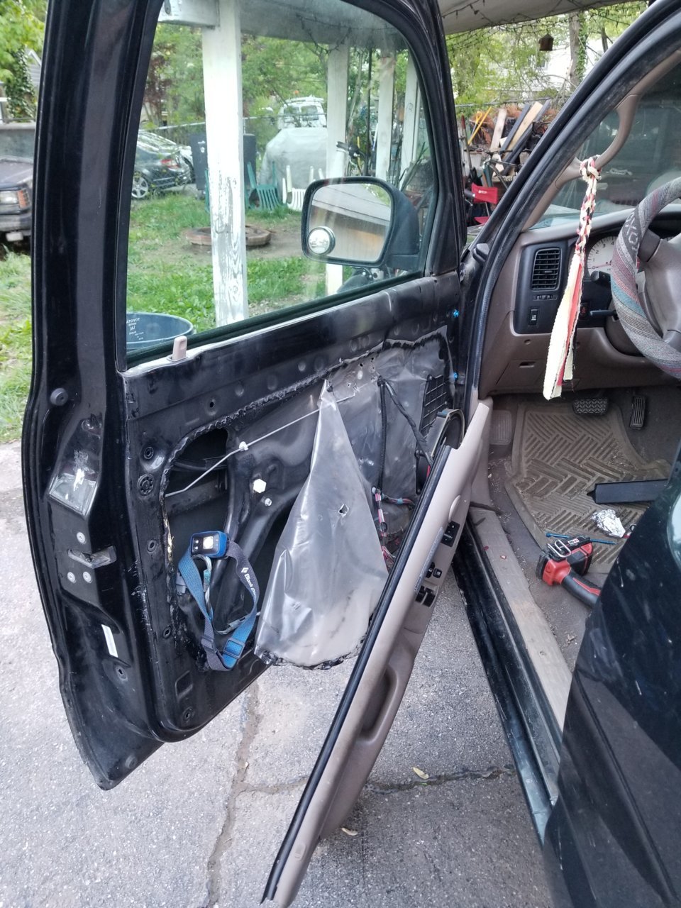

    Thank God for that video on YouTube! Getting the door open was the hardest part. Had to modify the spring since it was a bit bigger than the one that broke. But I doubt it'll ever snap again being almost twice the gauge of the last one. Cheers to all you for the support and assistance!

    those are strange pics, it looks like the drivers side is on the right side in one and other pic it is on the left?

    Yeah, the whole selfie thing throws ya off...
