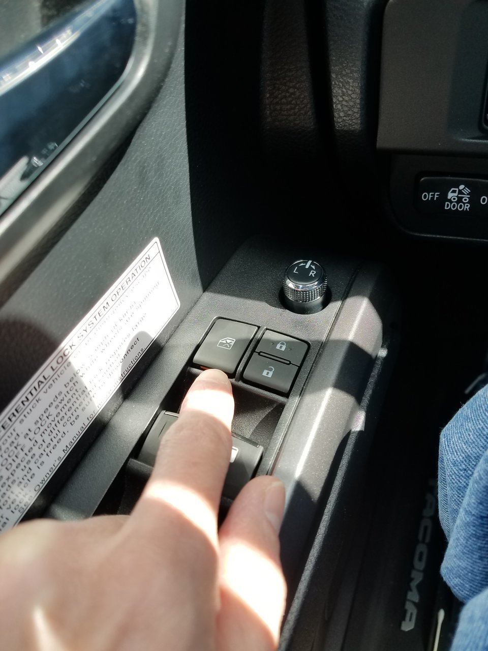

    Make sure you did not press this button.
  9. Mar 7, 2018 at 10:34 AM

    Wasn't the window lock button that one only works all the other 3 windows anyway does not lock the drivers window.
