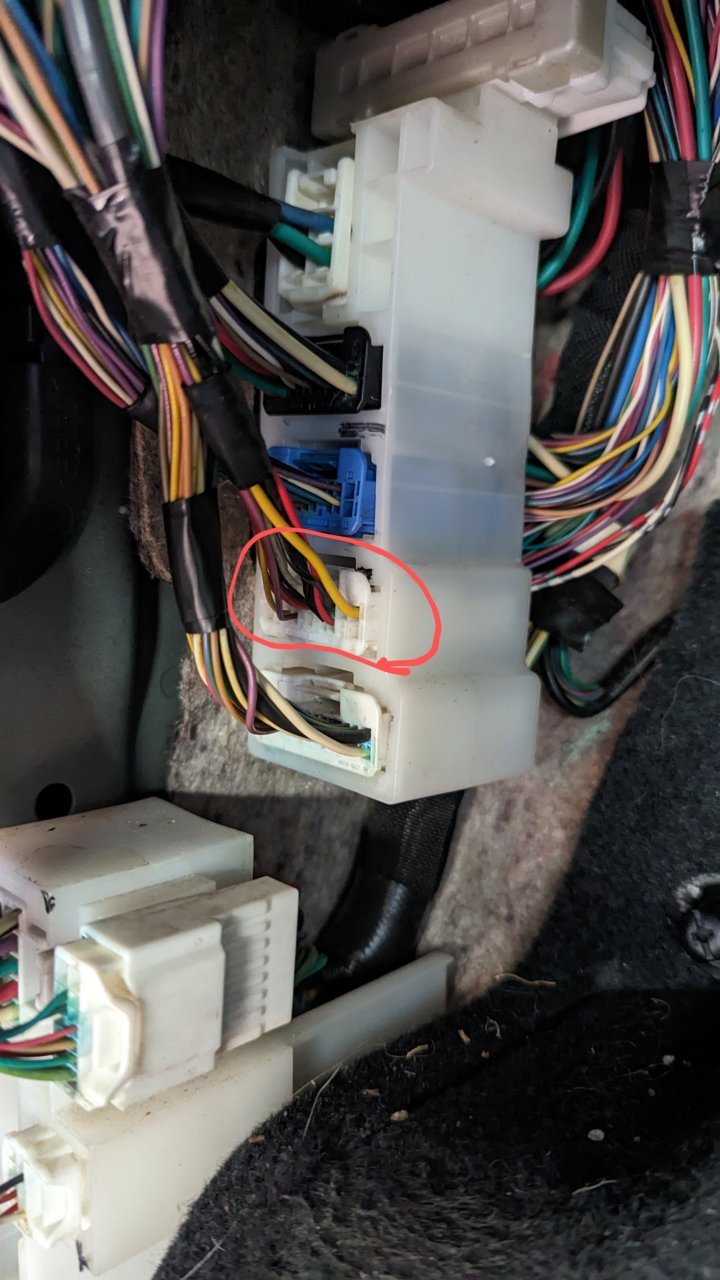

    I'm having similar issues with 16 Tacoma. I can't lock the doors from the driver side door but unlock works fine. I have to lock with the button on the front passenger door or with the key from the outside.

    I probably should posted this after I found it but forgot too. This plug was lose, I pushed it back in and door lock buttons started to work again.

    AIbot01 where is that panel you posted in your picture? Is that by the brake pedal to the left?
