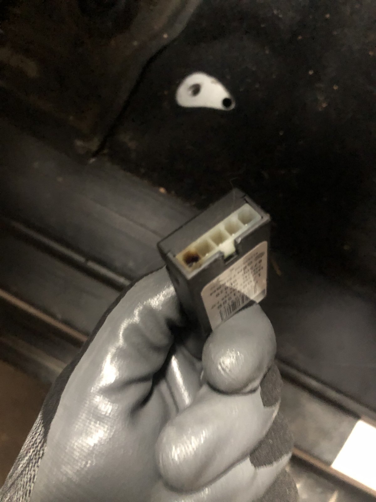

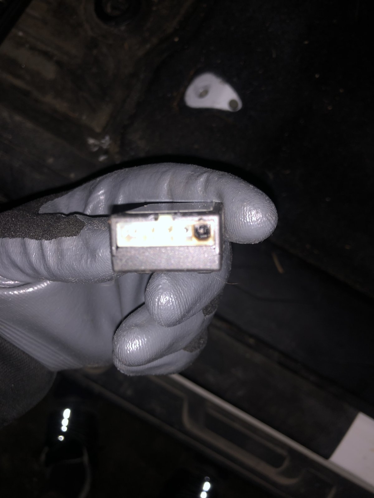

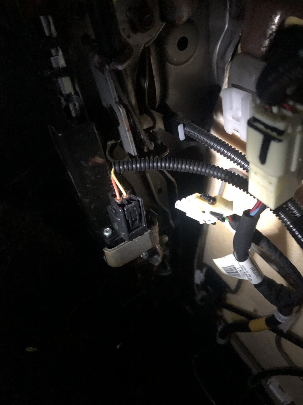

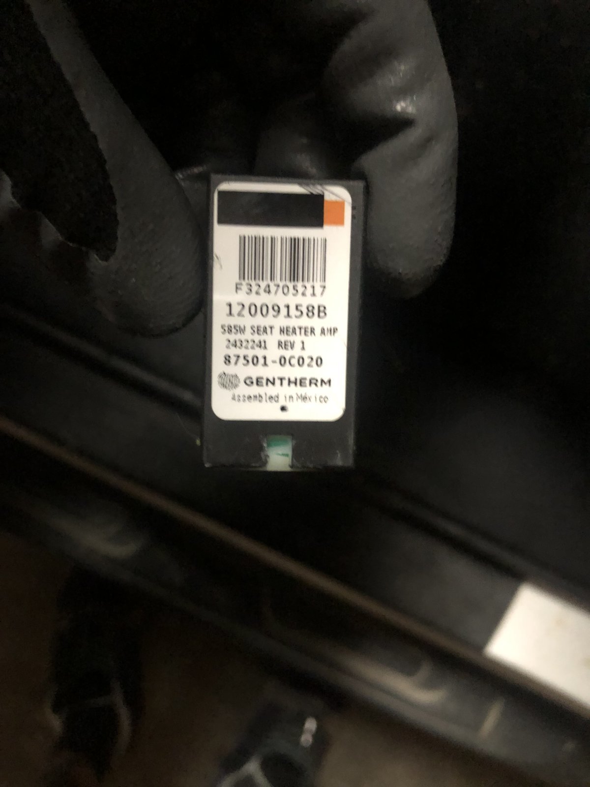

    Thank you forum world.
    I was smoking a j in my driveway and finally put effort into finding my drivers seat fault in my 14 trd 4x4 double cab. With like 300000 km, tons of spills, hunting in the truck, off roading, name it. Bought it new off the lot.
    A whole 5 seconds... ima swap the passengers lolll
    FUCKIN LOVE AUTO FORUMS
    Edit... I jumped to conclusions by assuming there's was one for each seat. There's not.
    Well played Toyota. Well played. Calling fuckyouship tomorrow for quote on part and male connector pin for self repair.

    You don’t want to use the same connector because that is one of the reasons they fail. You want a better quality connector. If you look back at my repair, you’ll see that a much better quality connector was used. I had this repaired about a year ago with no issues.

    What telephone # you use to call Toyota? I just had my driver side module burn up.
