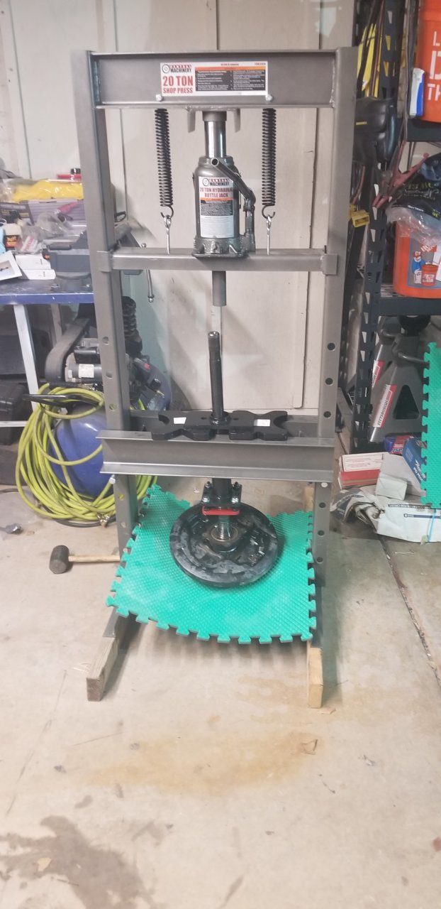

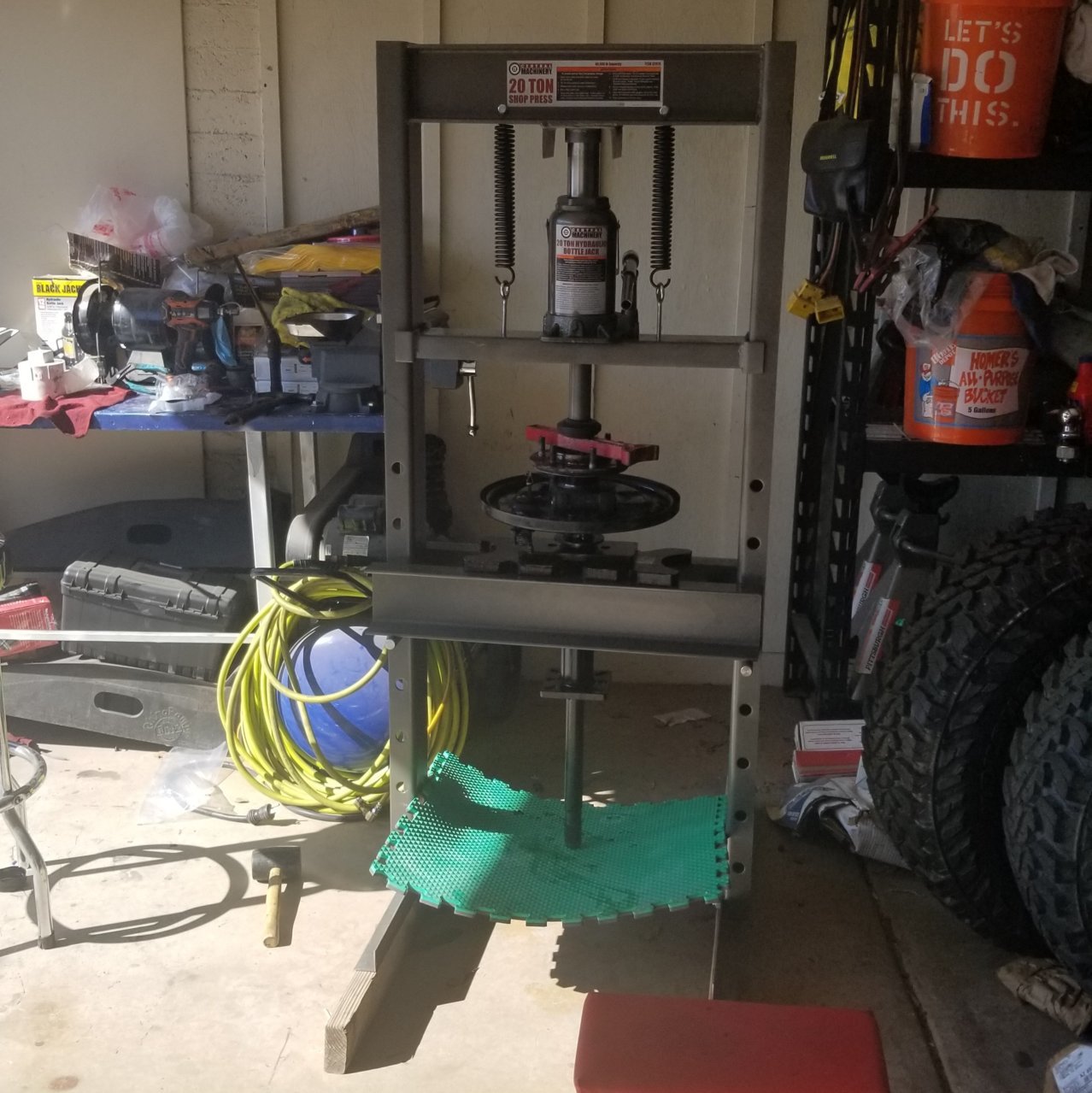

    Fyi this cost me about $700 to have a reputable shop do it a few years ago. I was pissed when it happened a 2nd time . I bought the tools for a little less and i now enjoy having a press handy now. And i can do my kids 4runner if it goes or mine if it happens again.

    You need to watch the videos. They require a press and a special adapter to pull the barings and tone rings
