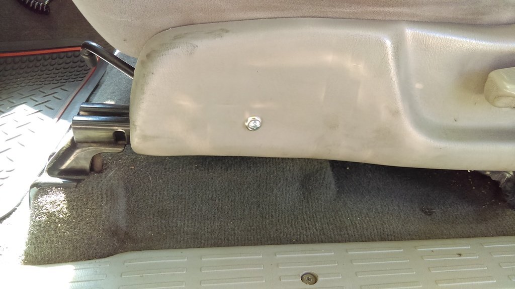

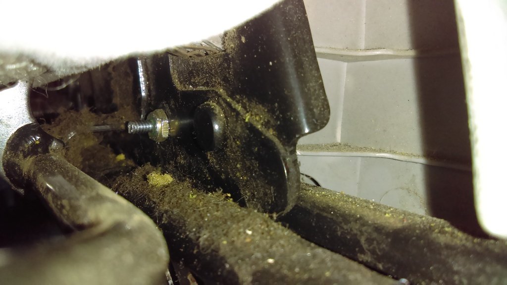

    I drilled a small hole in mine right through the plastic and the metal seat rail.
    Used a small 6/32 screw with small washer and nut.
    Havent had a problem yet.

    I thought about that. Just wondering if the washer is enough to spread the stress over enough area. Definitely a good fix.
    Maybe a spacer/stand-off between the trim piece and metal rail.

    I'll take a pic and show ya what I did.
    Took me maybe 10 mins to do.

    Here is what I did.

    That looks like it'll do it. Thanks.

    I did this to both of my seat's
    Works great!
