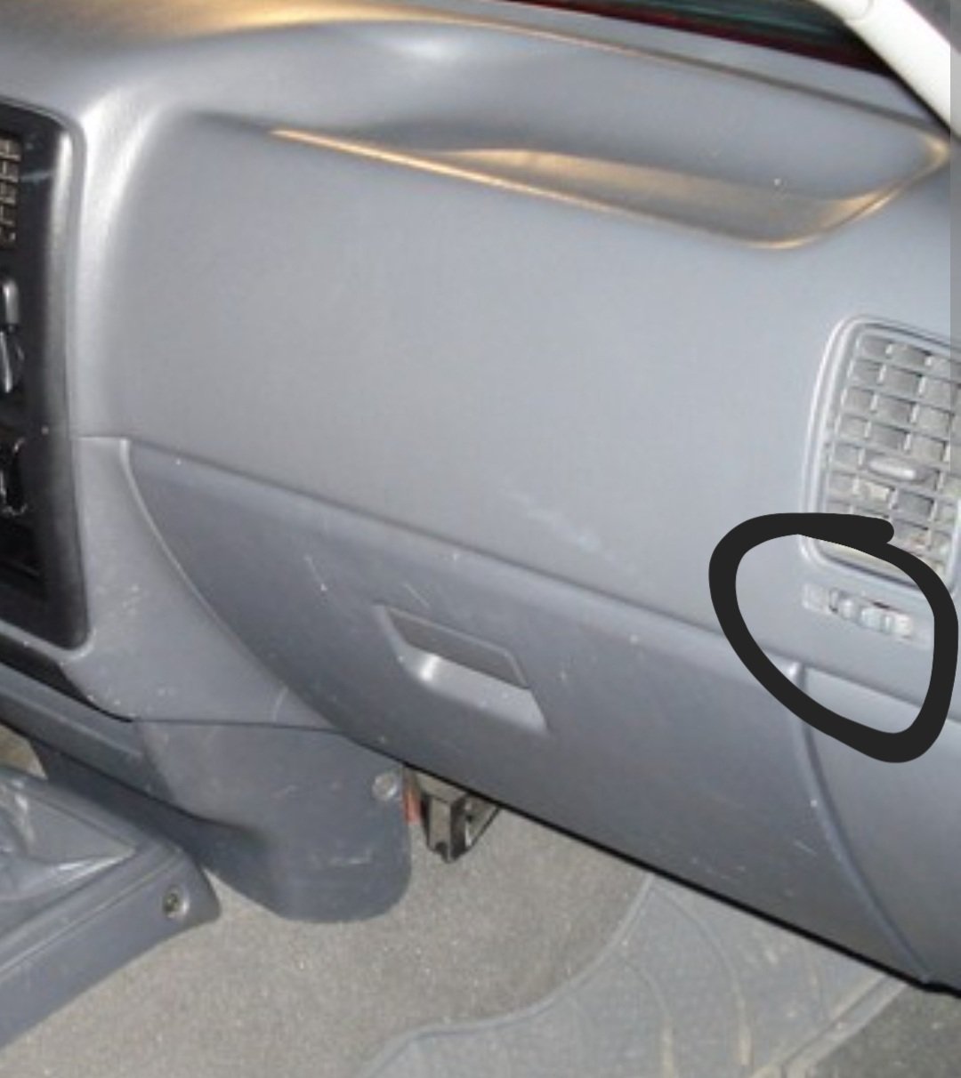

    1st gen driver/pass side vents have the damper on bottom.
    It is open, yes?
