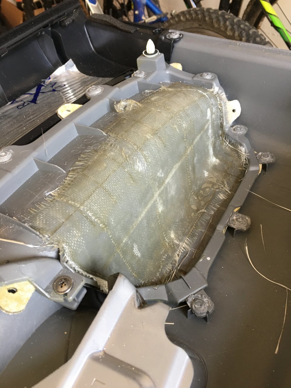

    Mine cracked in the same spot. I got a fiberglass patch kit from 3M and laid a few large layers underneath to try to spread the load out. It worked well, feels solid as a rock now. I do try to not pick myself up with my elbow on the armrest anymore though...

    Thanks guy, went online and found a marine epoxy kit and fiberglass cloth, worked very well.
    Before applying, I put a little super glue in the cracks and held into place so the epoxy set everything in proper place. I also wiped it down with alcohol, sanded and wiped down again.

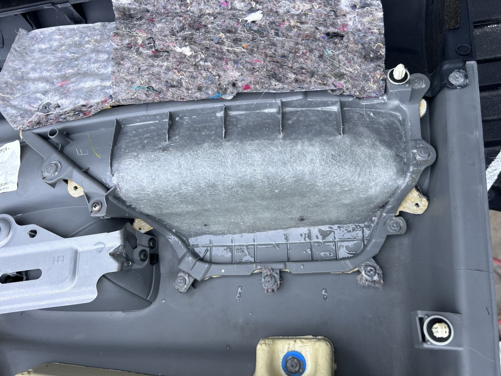

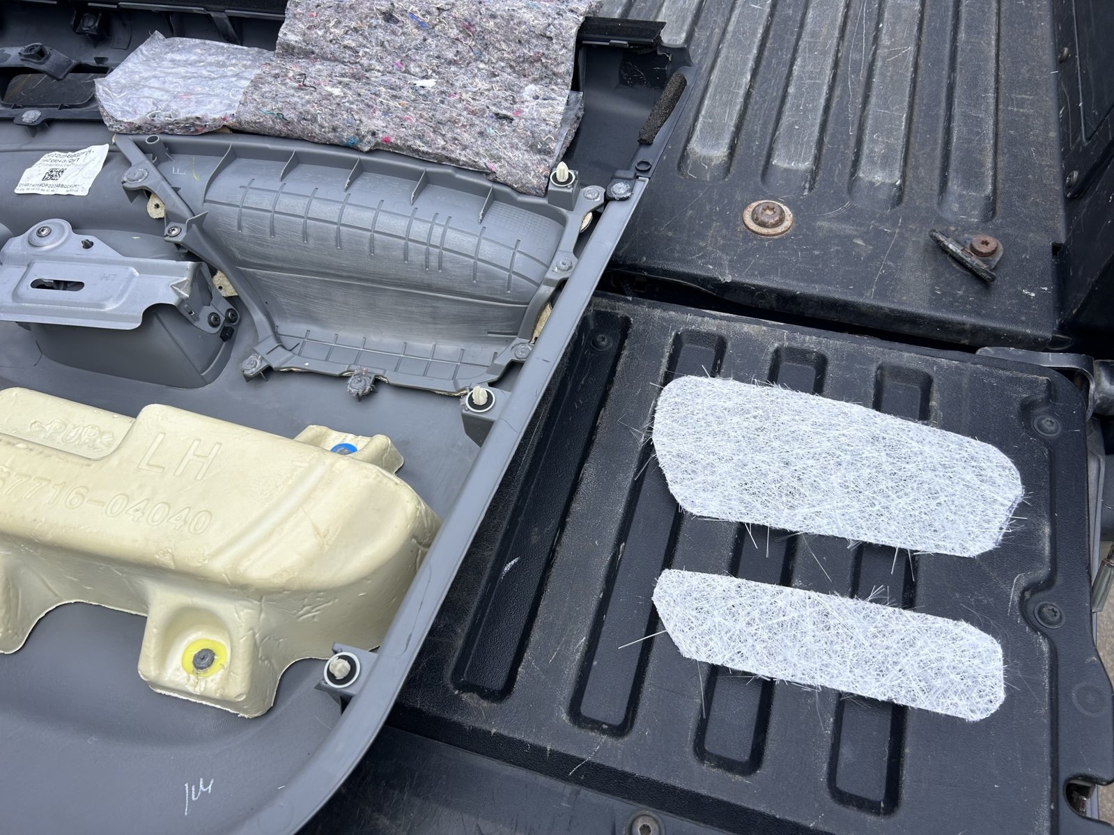

    I fibreglassed mine today.
    2013 Tacoma, drivers door
