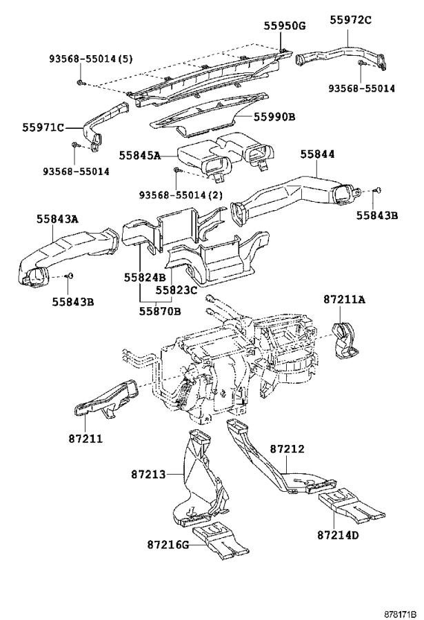

    Just a guess, but ductwork came apart or maybe clogged with debris?
    There's a lot of problems in my area with rodents getting into the air intakes and setting up camp.

    Take a close look at the duct work Ed.
    Look where the core is.

    Yea, I think i see that.

    Mouse and acorns?
