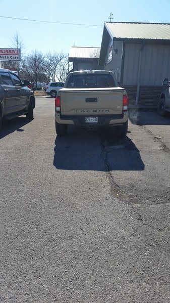

  6. Feb 11, 2016 at 11:02 AM
    Bumrush
    Bumrush [OP] Well-Known Member
    Apr 18, 2015
    #153428
    387
    Brian
    Middle TN
    16 TRD OR SB quicksand
    Here she is
  7. Feb 11, 2016 at 11:04 AM
    Swank
    Swank Certified Mall Crawling Instructor
    Nov 12, 2012
    #90979
    8,443
    Steven
    Greenville NC
    SOLD/TOTALED
    Need to install a 1/4" top plate spacer. Toytec sells them for around $30. Will fix your taco lean.
    It's because the gas tank, battery, etc are all on the driver's side. The extra weight makes it lean more towards the left.

  8. Feb 11, 2016 at 11:05 AM
    JKU3000
    JKU3000 Well-Known Member
    Nov 4, 2013
    #115910
    1,649
    John
    Birmingham, Alabama
    2014 Tacoma
    taco lean... small spacer from toytec will help... yea what he said ^

  10. Feb 11, 2016 at 1:12 PM
    Buddha717
    Buddha717 Well-Known Member
    Nov 4, 2015
    #168680
    256
    Ron
    Harrisburg, PA
    2016 Inferno Tacoma TRD sport DCLB PTJBL
    If you put aftermarket springs on then you will have the lean unless you use a spacer. Toyota OEM springs are different right to left. This is to compensate for having the battery, driver and fuel cell all on he same side. Install the spacer like swank stated and it will be fixed.
  11. Feb 11, 2016 at 1:31 PM
    Broccoli
    Broccoli Well-Known Member
    Oct 16, 2015
    #166833
    2,096
    Airdrie Alberta
    2016 trd sport blazing blue,
    Or if your bilsteins are adjustable just crank up a notch.

  13. Feb 12, 2016 at 7:03 AM
    Buddha717
    Nov 4, 2015
    #168680
    256
    Ron
    Harrisburg, PA
    It's not a toyota issue. If you put the stock springs back on you will see the lean go away. Your truck didn't lean when you got it. when you change to aftermarket suspension the springs are equal and don't compensate for what Toyota did with the stock springs.

  15. Feb 12, 2016 at 10:18 AM
    because_wumbo-truck
    because_wumbo-truck TTC#036 1st Degenerate Urban Off-Roader
    Jun 16, 2015
    #157552
    50,209
    Jon
    Houston, Texas
    2006 Gordita Blanca V8 4x4 aka "Penelope"
    Sliders and bumper, DDI injectors, flowmaster 40
    That's not normal for a brand new vehicle unless you're like 500 lbs
  16. Feb 12, 2016 at 10:21 AM
    #16
    T4RFTMFW
    T4RFTMFW Well-Known Member
    Jul 23, 2014
    #134525
    69,788
    Driver took the picture so driver weight makes no difference.
    Not sure if serious.

  17. Feb 12, 2016 at 10:21 AM
    #17
    because_wumbo-truck
    Jun 16, 2015
    #157552
    50,209
    Jon
    Houston, Texas
    Sounds like he only leveled it with 5100 struts. Shouldn't be happening either way. The stock driverside coil is supposed to be a little longer than the passenger side to my understanding. Maybe the tech at the factory wasn't paying attention and reversed them :notsure:

  19. Feb 12, 2016 at 10:34 AM
    #19
    jsinnard
    jsinnard Well-Known Member
    Feb 4, 2009
    #13279
    6,679
    J
    Virginia
    16 QS DCLB OR 4X4
    That's what I'm thinking, springs got reversed in the swap to bilsteins.

  20. Feb 12, 2016 at 12:42 PM
    #20
    T4RFTMFW
    Jul 23, 2014
    #134525
    69,788
    That would cause his front end to dip low. Not the entire truck. His rear leafs aren't drastically effected by a minor shift in his front coils.
    Whole truck is tilted half inch to driver side? Sounds familiar..
