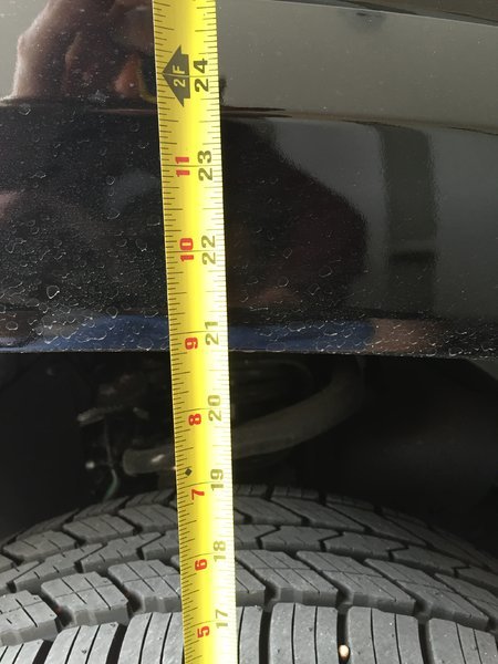

    227
    TRD sport 2016
    Driver side
    Passenger side.
    This is on brand new truck with 1/4 tank of gas. I don't think there is any difference in front springs, left or right, they both have same marking on them. Usually spring would have red marking for one side and green for other(just example) my truck had same marking on both springs.
    Edit: I also get about 1/2 difference in rear with full tank of gas. Full tank of gas weight approximately 180-200lb

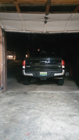

    mine has a significant lean too..havnt measured it..but its bad enough when i leave work..people ask me whats wrong with my new truck. Then add my 230 lbs in the driver seat its noticible when driving and turning. All vehicles have a prominent lean (trucks mostly) but this is a little ridiculous.

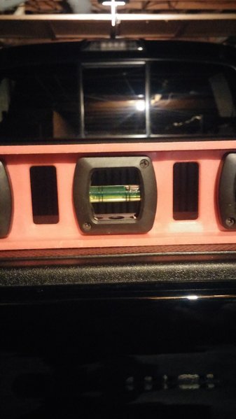

    Mine is doing the same thing it leans on driver side. Put a bubble level on it too just like Pportera
