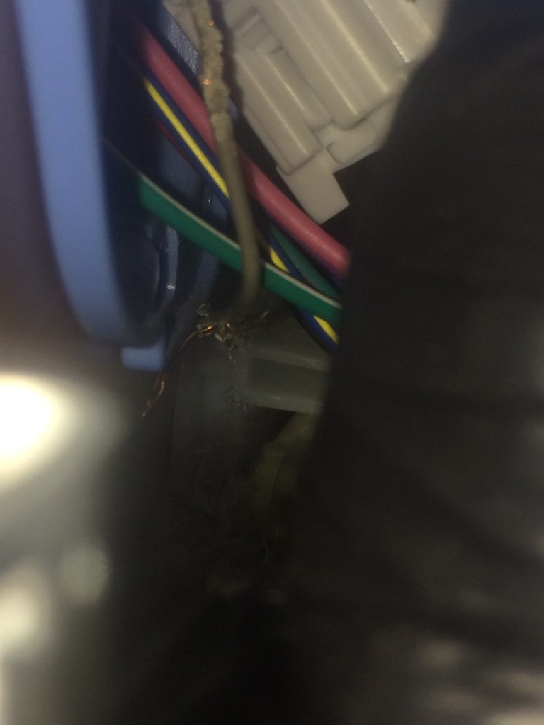

    @Muddinfun and @Styx586 thank you both for helping out. I actually had a rat(a legit rat) inside my cab and dash about a month ago. It was during this time that the switch stopped working. I chalked that up to coincidence as a switch can go bad anytime. Since then I've ran across another problem. It looks as though my fear of that rodent destroying wires my have came true. I started to think today and in the recent time frame, the rat seems be a logically suspect. Who knows:notsure:I've Done basic install of wiring up auxiliary lights before and tried changing out the switch to no luck; but I believe this task may have just gotten out of my comfort zone. Thanks again guys and I'll go back through and read over your guys posts again.

    I called myself checking, but damn, there are wires galore. I actually reached out to my agent today, to see about starting a claim, but he is out till thursday for his birthday. When I discovered that I had a rat, I called him to see if I would be covered, if the worst case scenario happened. He was actually stomped by the situation saying he never seen a claim like that before. He did a little calling around, and I'm covered, if I have to go that route. I feel like this situation should be a farmer's insurance commercial.

    Well I just found one chewed wire. It is indeed the gray wire. So that explains why it won't unlock.
