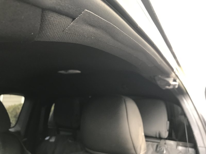

    Fixed it!

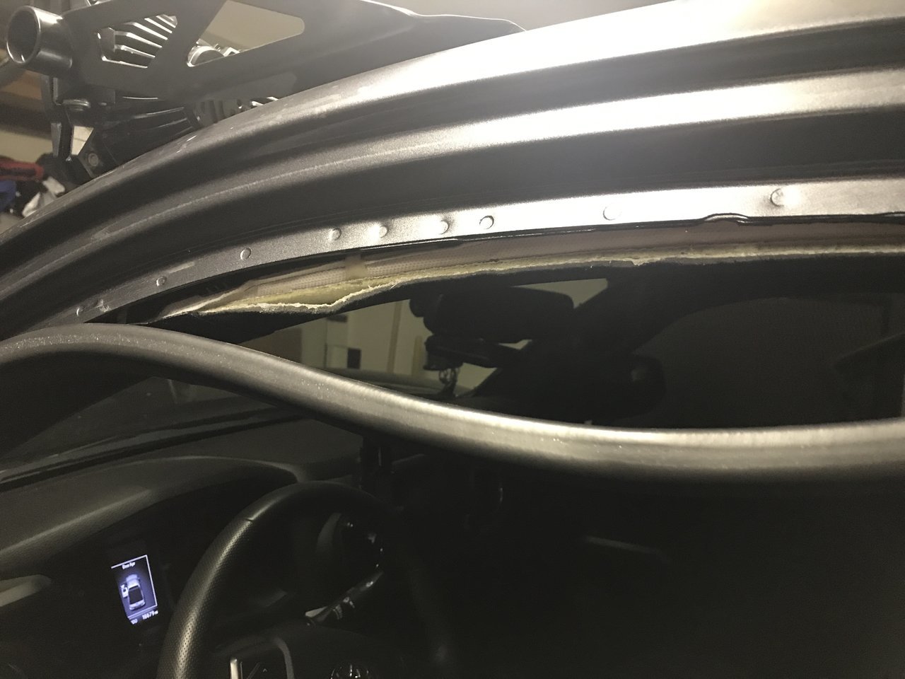

    So I finally decided to do something about this hideous headliner. The tape just fell off immediately. Took the trim off fully planning to just glue everything together.
    Then I realized maybe the headliner isn't too small (still could be) but more that it's separating. So the outer layer is what's falling out and not the whole thing. See picture:
    What I did was just glue the outer piece back on to the foam backing. It's only been two days but it hasn't popped out yet. Prior to gluing it wouldn't last five minutes before popping out.
    Let's hope it stays that was because it's a little embarrassing.
    :fingerscrossed:
