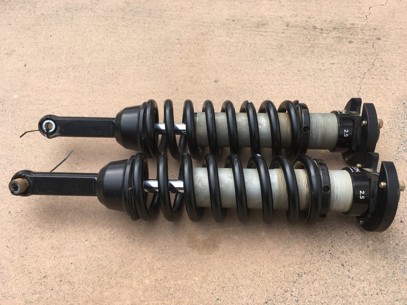

  5. Jul 7, 2016 at 9:20 PM
    EDDO
    EDDO                         
    Mar 12, 2014
    #125165
    4,020
    Eric
    San Jose, CA
    19 TUNDRA
    Plenty of lean on my 2013, corrected with preload. The top one in this picture was on my driver side.
