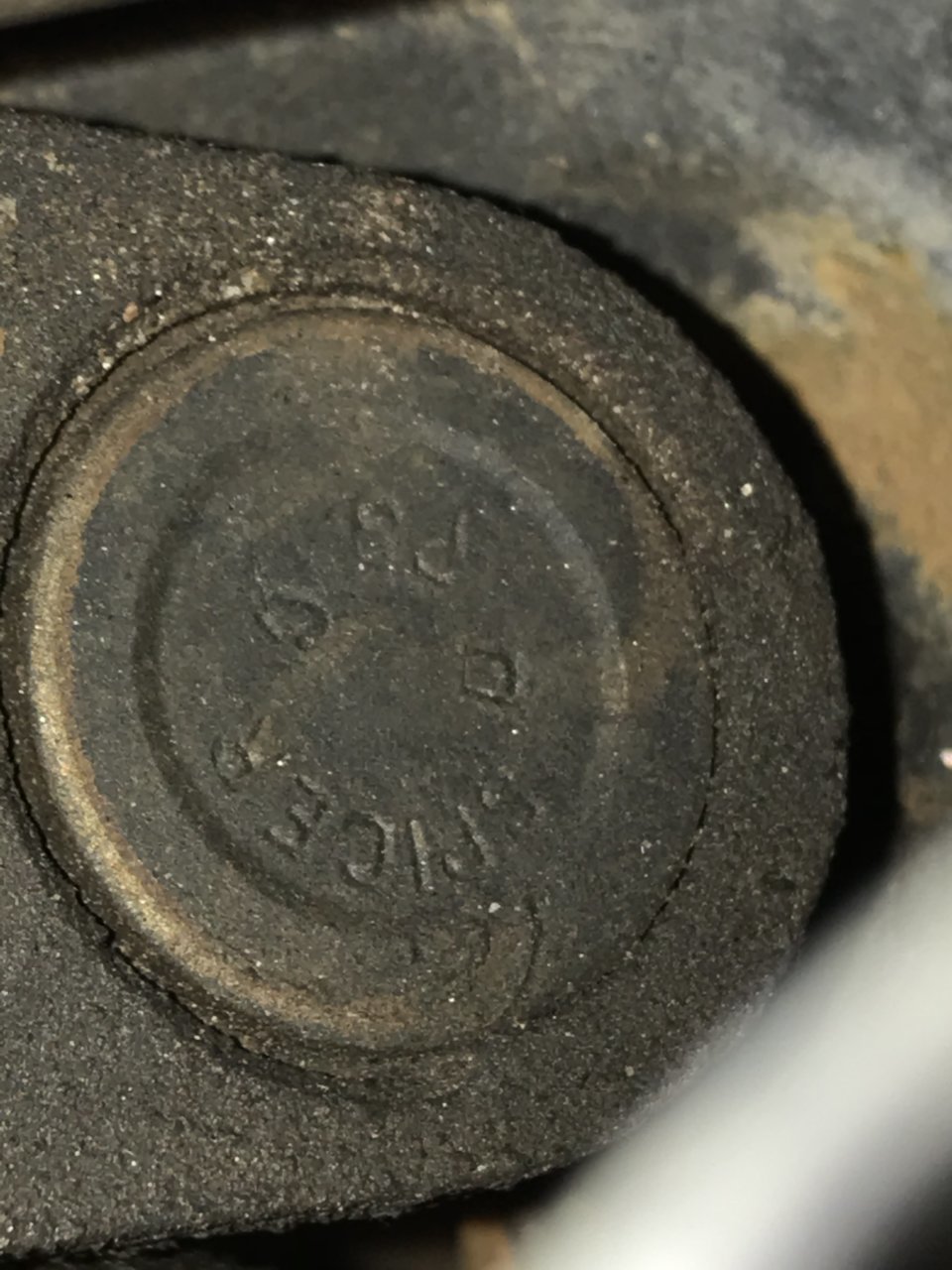

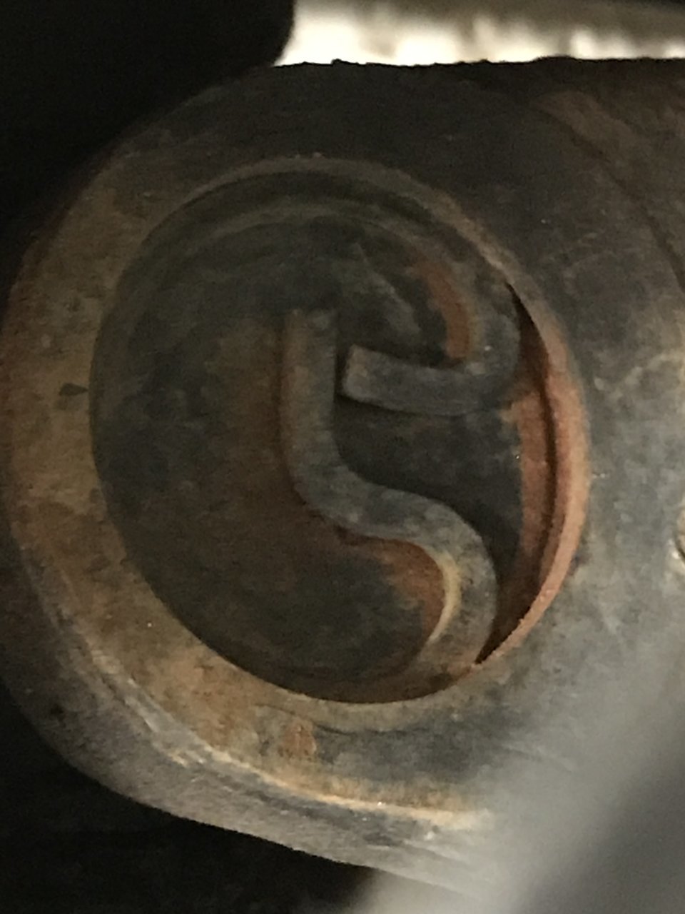

    my 18 has a vibration in 4hi that would come and go . Never really spent anytime pursuing a answer ... last friday I racked my truck to change the oil and grease it . while the oil was draining I grabbed my grease gun and rotated the front driveshaft to access the zerk fittings and to my surprise the driveshaft moved while I rotated it . the rear joint is missing a circlip and a cup was about 1/4inch out of the yoke . I have a stash of the select fit circlips so I grabbed a brass drift and gently tapped the cup into place . When I went to install the circlip I found the problem , there is no groove in one side of the yoke to retain the circlip ! currently waiting on a new shaft under warrantee ..

    C99F5831-006C-495D-80B6-3E706A75C28B.jpg 8377C412-D8BB-4FD9-A0CB-40007449E9A3.jpg
