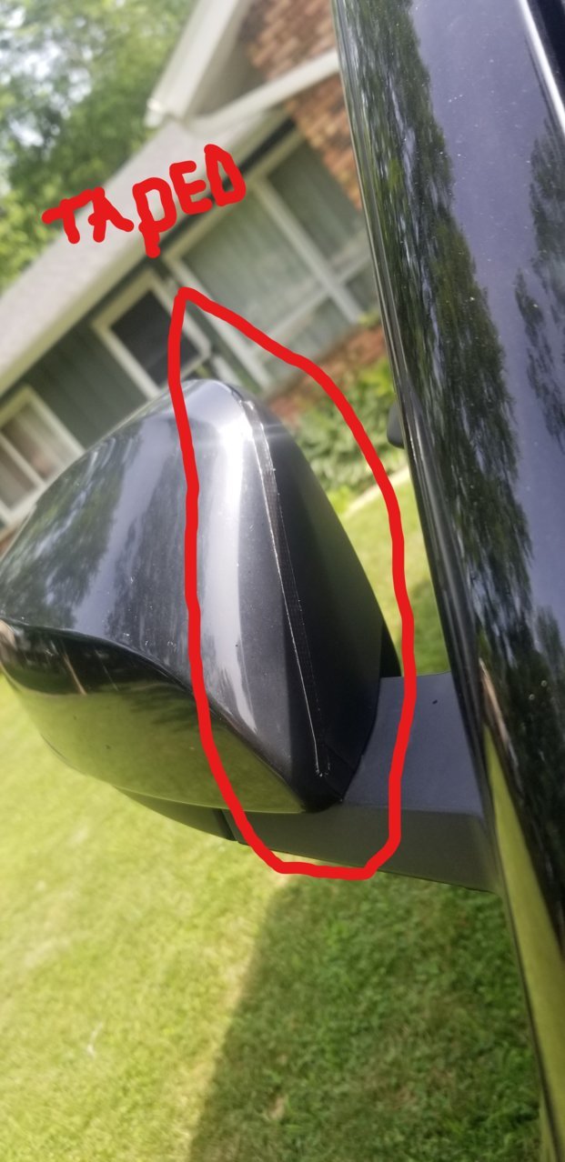

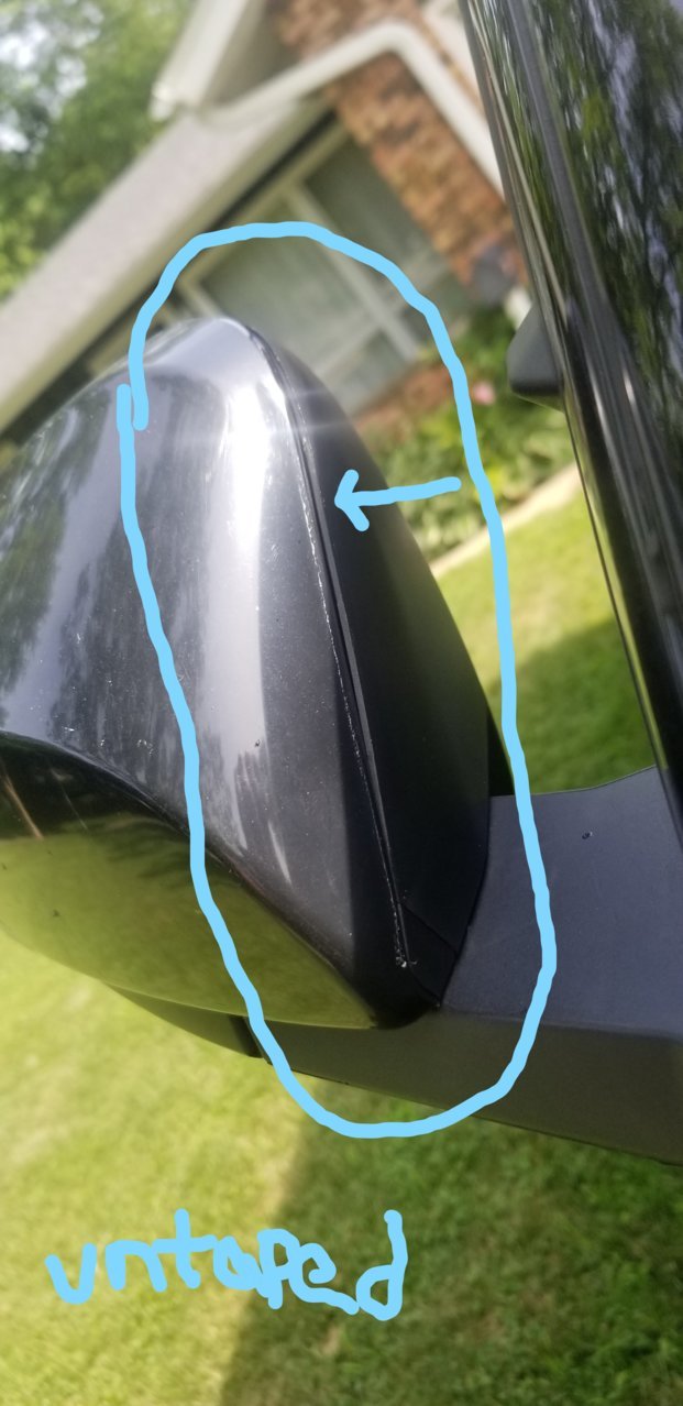

    I have a 2017 Toyota Tacoma TRD 4x4 (extended cab). I had constant whistling noise on the passenger side when at 40 and above MPH. Read some things here that helped, and I found out it was the slit on the side view mirror that was catching air and causing a whistling noise. Attached are pictures of where it is at. I am still not sure how to fix it. I put a piece of tape on it, but I want a permanent solution. I am considering putting caulk in the space--but anyone else got a better suggestion?
