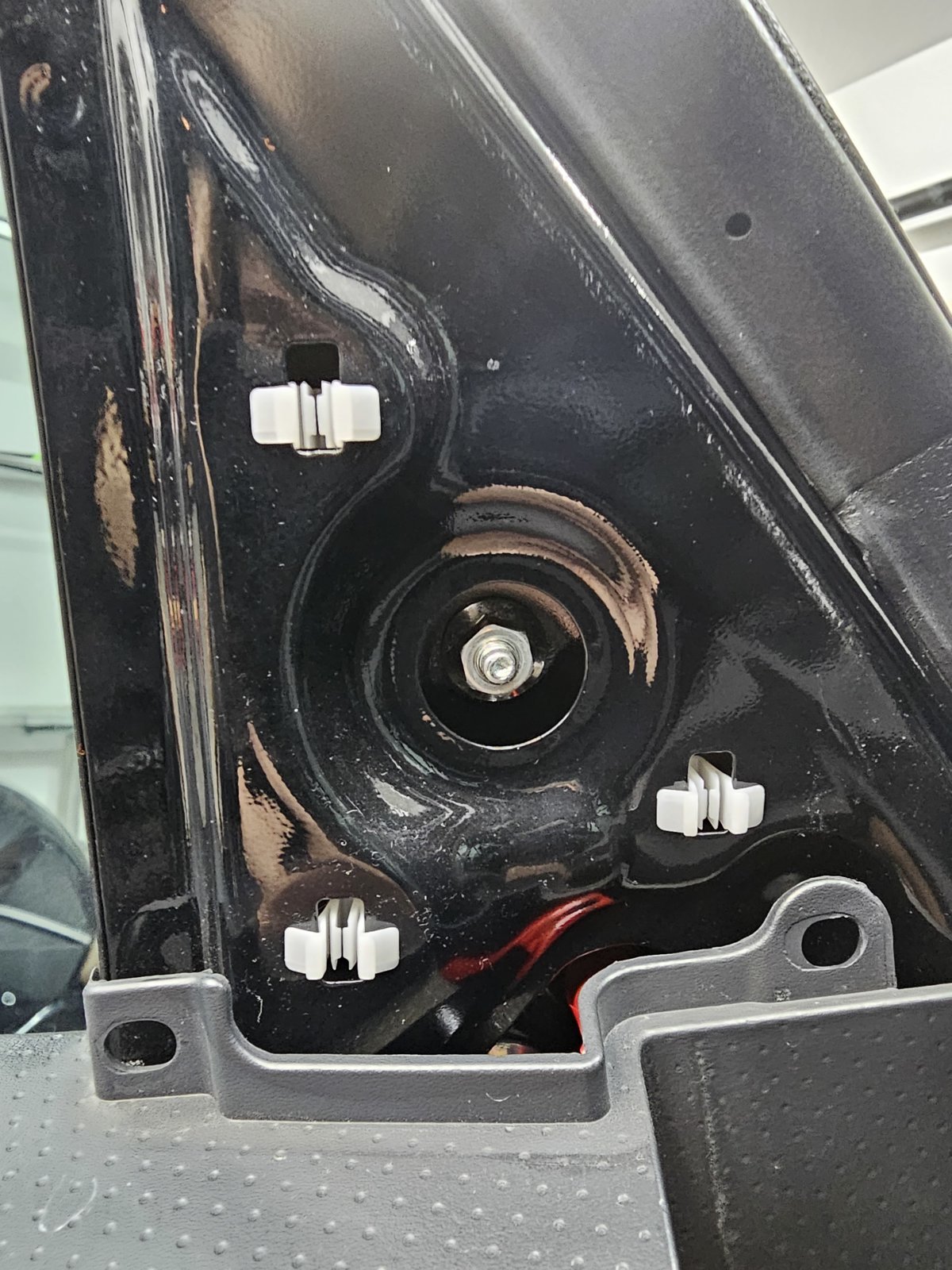

    I may have found something, at least it helped on my 18. And sorry if this has been mentioned before.
    I noticed my wind noise was coming from the A pillar area near the mirror. I Just finished a 2000 mile road mile trip so I had lots of time to poke and push on parts.
    I pushed on the sail panel, the triangle shaped one nearest the mirror and the wind noise stopped! So I pulled the panel off and immediately lost all the clips, but I layered up some electrical tape near the edges and seams and covered the open holes on the metal, then stuck a piece of foam under the panel, got new clips and reinstalled.
    Took care of probably 99% of my noise! Hope this works for someone else too!

    Is anyone aware of where these "3 plastic tape lenses" are supposed to be located? Is this on the outside of the vehicle? I pulled the small inside corner panel off and this is what it looks like:
    Edit: I just realized this is a 3rd gen post. Anyone know if this applies to 2nd gen?
