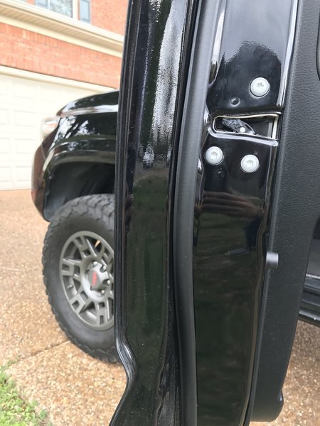

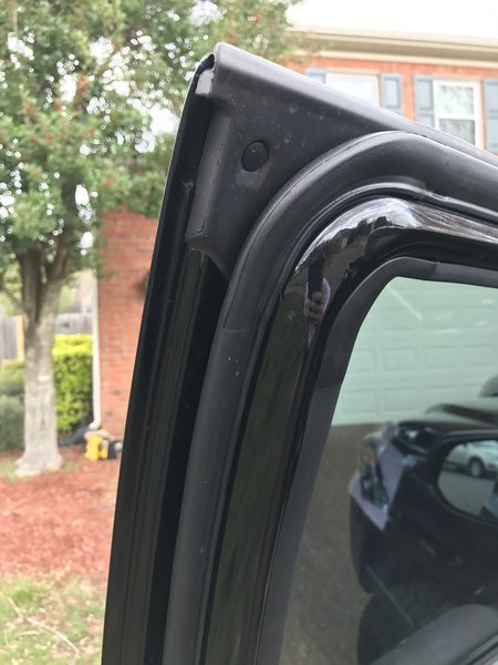

    Took mine to dealer and showed video of the sound head service tech took a test drive with me. Heard the noise and they replaced the doors seals both sides. He said that was making the sound. He also said after he installed the news seals they were thinner and he believes the thickness of the seals was the issue. Since I have had 0 noise!!! So happy now. Toyota's news seals are thinner than factory ones that came on the truck.

    Would you be able to take a picture of your door seal? I have a 2017 Pro that i got in early feb. I get a whistle at 105km/h in my left ear that is driving me nuts. Would like to compare the picture to my current door seals.
    I have brought it to dealership once already about the whistling. They confirmed the noise, said they made some adjustments and told me it was fixed.
    Thanks
