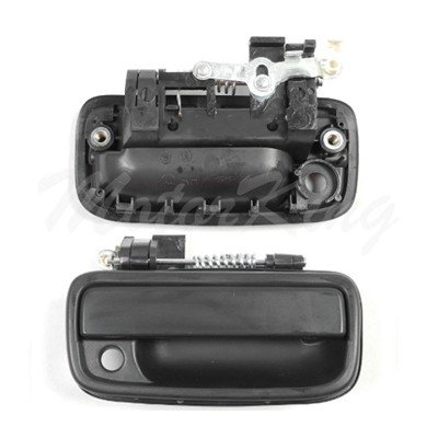

    Had the same problem twice on my 97, fixed it for free both times. Once removed if you look at the exterior handle on the inside you'll see the cams on the handle that you lift up to open the door. The cam pushes an arm, been day or two sense I done this but believe it's the arm that the rod hooks to, anywho this arm is the problem. It gets bent inward toward the cab of the truck so the handle does not push it properly casing the door not to open. I simply bent this arm back out(tight up against the handle itself) and it works like new. Hopefully this is understandable, I know it's hard to see without pics, but if you have the handle out and play with it for a bit it should be pretty obvious

    Looking at this picture I found:
    Is it the flat piece near the top, with the pivot on one end, and the clip for the rod on the other end? Or is it the rod itself?

    Yes, the silver part with the plastic clip for the rod attached to it. On mine this part was bent inward, towards the cab and away from the handle itself. I simply bent it with pliers to where it was tight up against the handle again and it's good as new.
